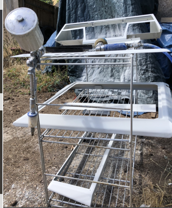

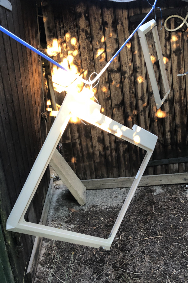

Did a bit more today

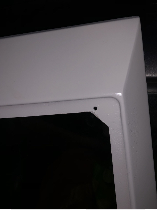

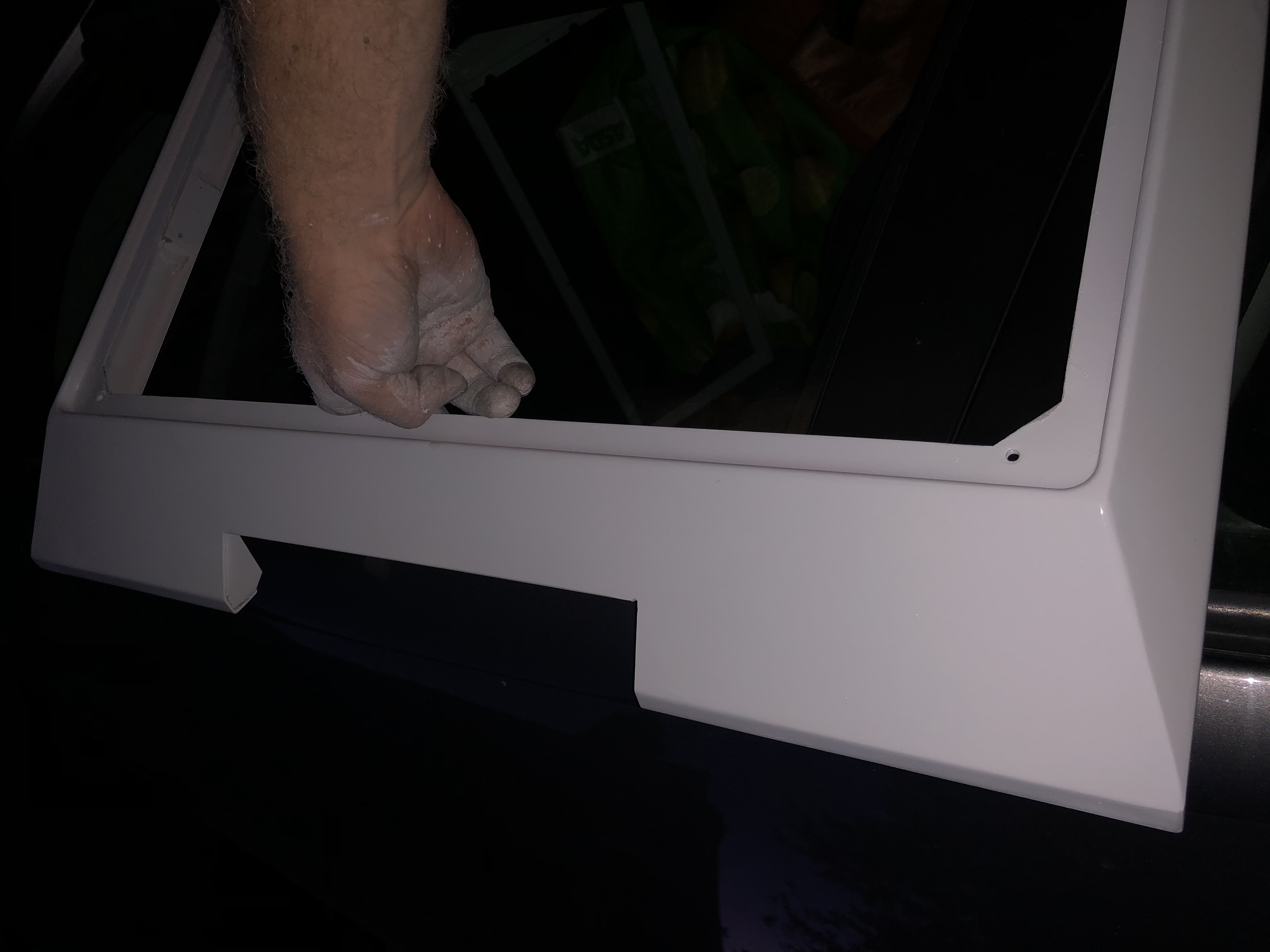

Top coat / clear coat

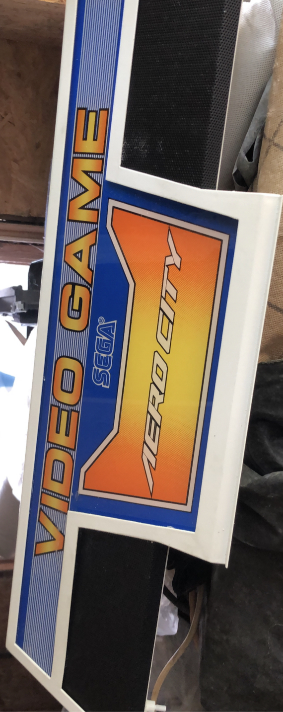

Polished light marque
Reassembled the light /speaker marque header .
G3 scratchy remover polished the marque.
Sprayed speaker grills ..
Next step Strip & spray main body /control panel lower ..
Just some before shots showing state of the
Rust & dents etc whilst stripping
2k Build up primer / fine upol body filler / wet& dry sanding between coats/ then top coat / then clear anti scratch tough coat. Retroman8392022-07-24 22:09:12
