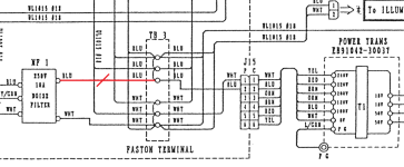

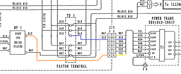

No I definitely blew it by connecting EU mains directly to the screw terminals of that PSU when it was out of the machine.
Anyway, for future reference, below is the corrected version of the schematic.
