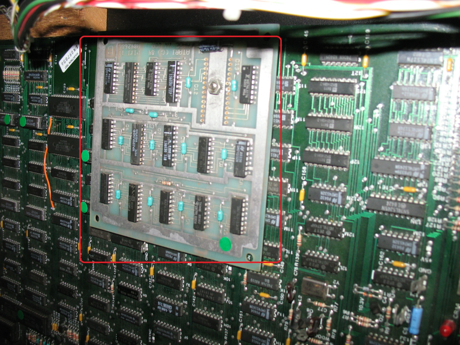

But you might be able to help - I have a working board that is missing little square 'daughter' board. Do you know if these daughter boards can be sourced from anywhere? iamjimmi2015-01-03 14:30:46

Or are we talking about the 'Pixie' board. 100mm ish square board towards the middle of the board. I think it handles all the background graphics?
Not sure if it's used in any other games, You game should run with a green background without it, but all sprites and game text should still be visible. I was running mine without it yesterday when testing.

I am not sure that is the one. I have attached a pic with the missing board highlighted (obviously the board isn't missing on this photo!)

Back to my original question - from the photo, do you think that board is the 'Pixie' board? If I can identify it, I can start to look out for one (or post a WTB).

In the Atari manual its called: PIXI II PCB part number A04268601
It's probably a good candidate for a custom FPGA type device like ColinD did with the SLAG device, it has some 74 series logic a couple of Proms and some RAM.

Pretty sure these are only used on ROTJ. Pretty hard to come by, someone needs to have scrapped (or lost) a mainboard to have one spare. As you know they are pretty useless without the other board.
