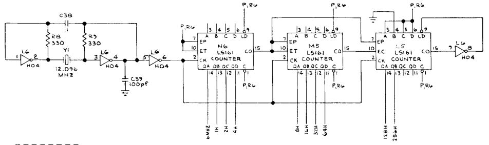

The image below shows the Horizontal timing part of the circuit:
The main 12MHz clock signal was good and all the horizontal timing signals from the outputs of LS161's at N6, M5 and L5 were all correct and present. It was time to scroll down page 4-5 and look at the horizontal timing signals.

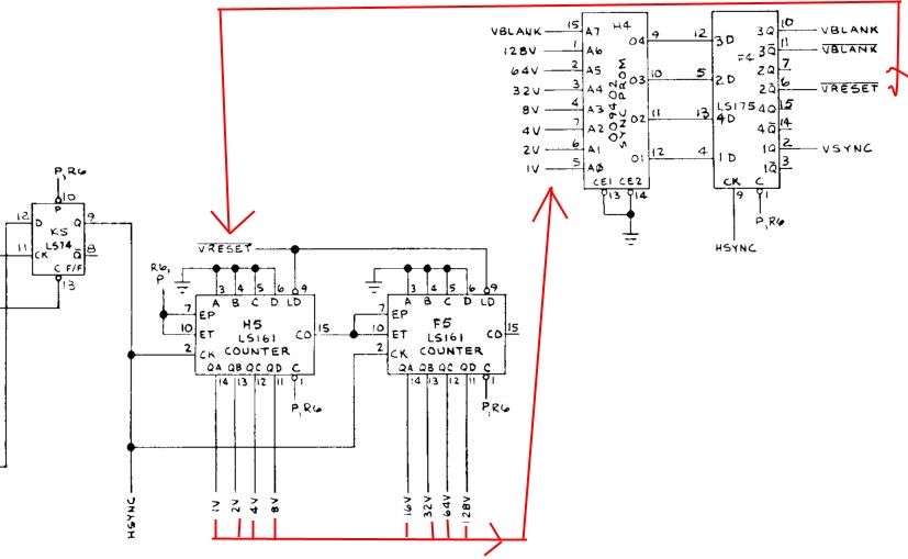

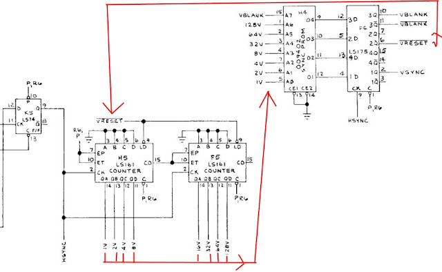

Image below showing that part of the circuit:

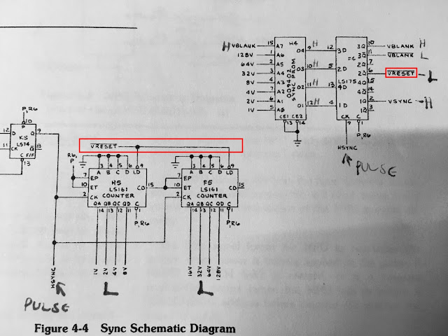

As I noted on my printed schematic, all of the vertical output signal were low, these should be seem to be pulsing on a logic probe, I noted that the *VRESET signal was low and incorrectly thought the LS161 at N5 would have been faulty. I removed this from the PCB and tested it and was proven wrong, it was OK. I should have studied the data sheet further, the way these LS161's are used in the circuit requires a state change on pin 9.
The circuit creates a loop where the output signal *VRESET from pin 6 of F4 is needed to make the vertical timings active which in turn are used via a PROM to generate the *VRESET signal... confusing or what!
The above image shows the signal flow of what I tried to explain. Moving on I manually forced the *VRESET signal high whilst monitoring the vertical outputs on my logic probe, it would get high outputs on the vertical clock signals and would then hear the game reset.
Next I decided to remove the LS175 from F4 and test it. I was running out of IC's which could be at fault! :eek:) This turned out to be fine which should have left me with the 'SYNC PROM' at H4 being the problem, I had no easy way to test this so I removed a similar PROM from my Fire Truck cab and fitted it to newly installed IC socket and boom the game was running again! I have sourced the correct PROM and one of my arcade buddies has programmed it, so once I collect it i will be able to consider the game fully working again.
