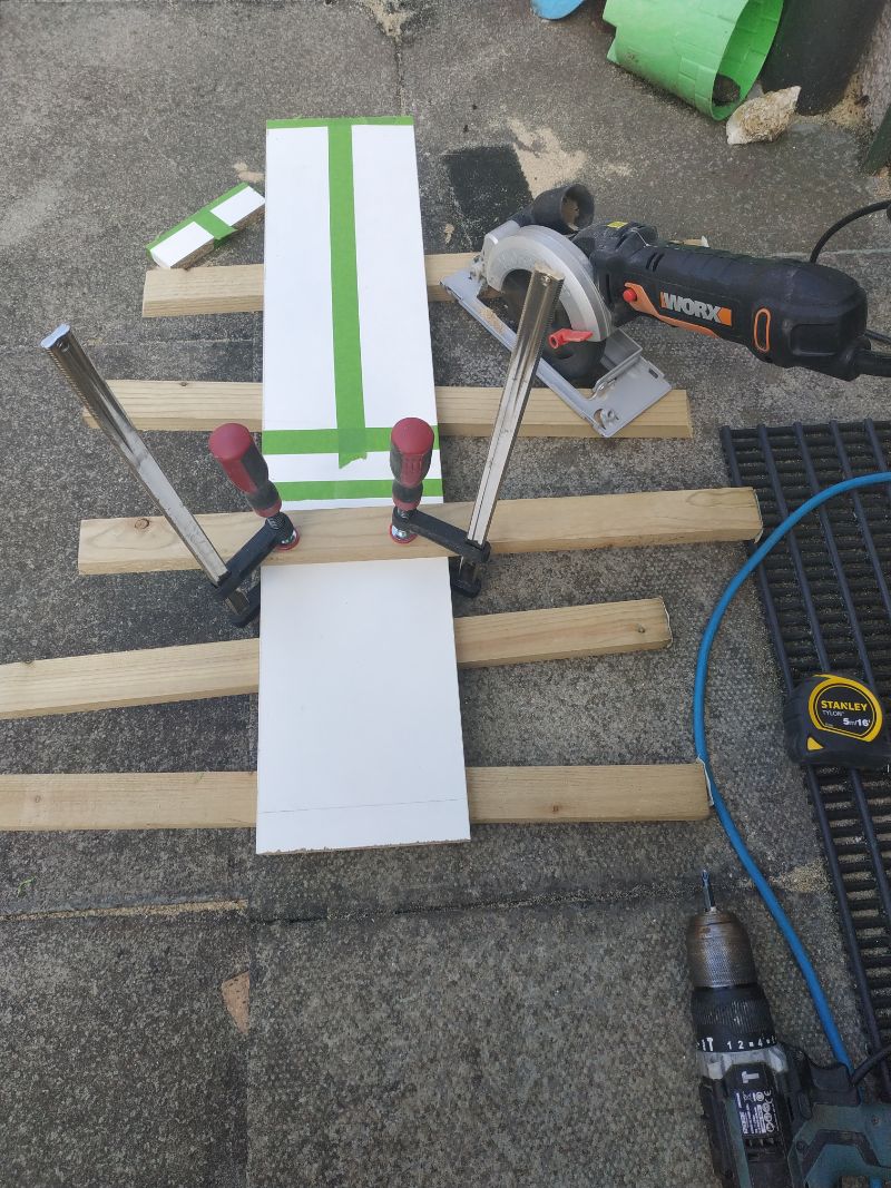

1) Get some cheap bits of melamine-coated MDF
2) Measure where you want to cut, secure lines with tape and cut fine-side down (this minimises cracks and chips in the melamine)
3) Cut some extra bits for the inevitable mistakes!

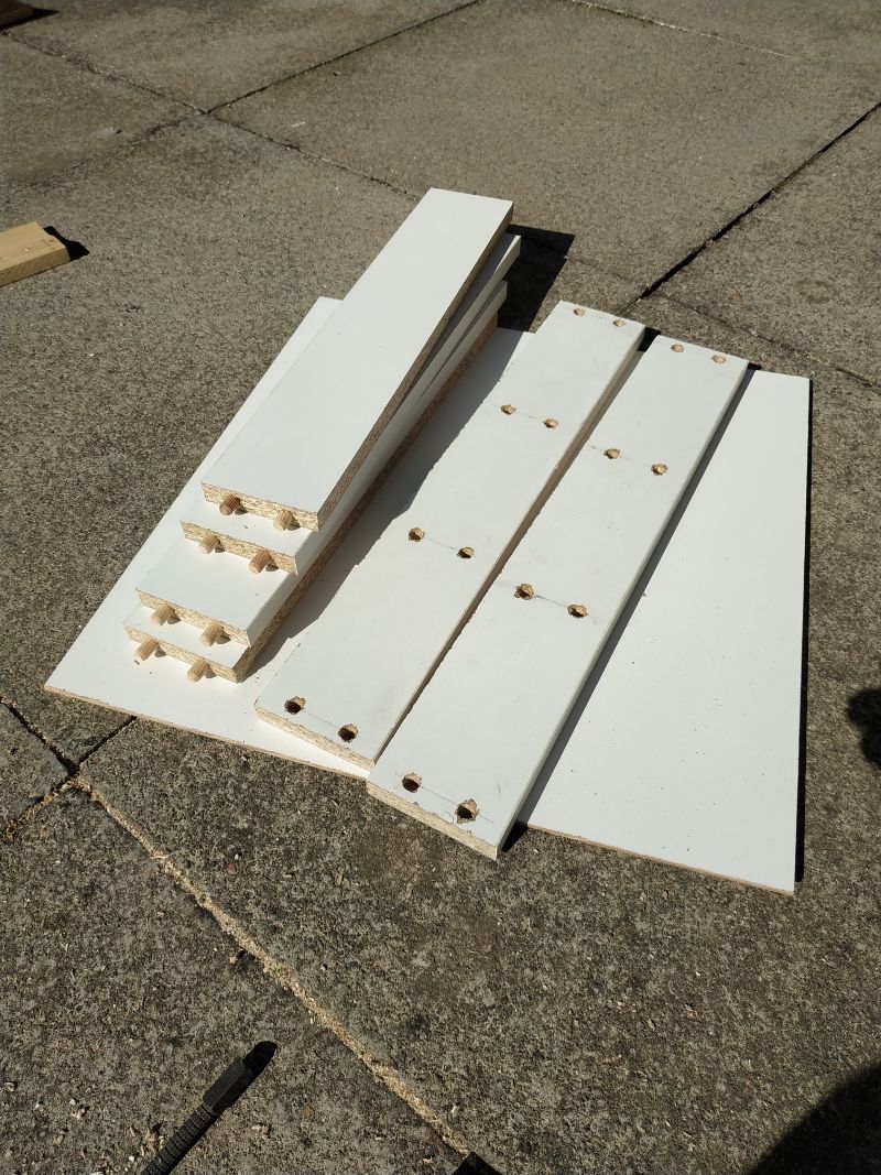

4) Mark again for dowel pins, drill pilot holes and then full-size holes
5) Run out of dowel pins, order some more and wait for them to come
6) Glue dowels, secure back panel with panel pins

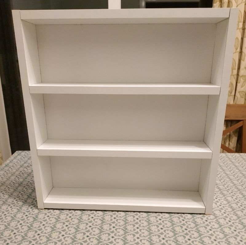

7) Disguise ill-fitting edges with soft furniture wax
8) Don't look too closely at it
It's not perfect but it'll do for now.
