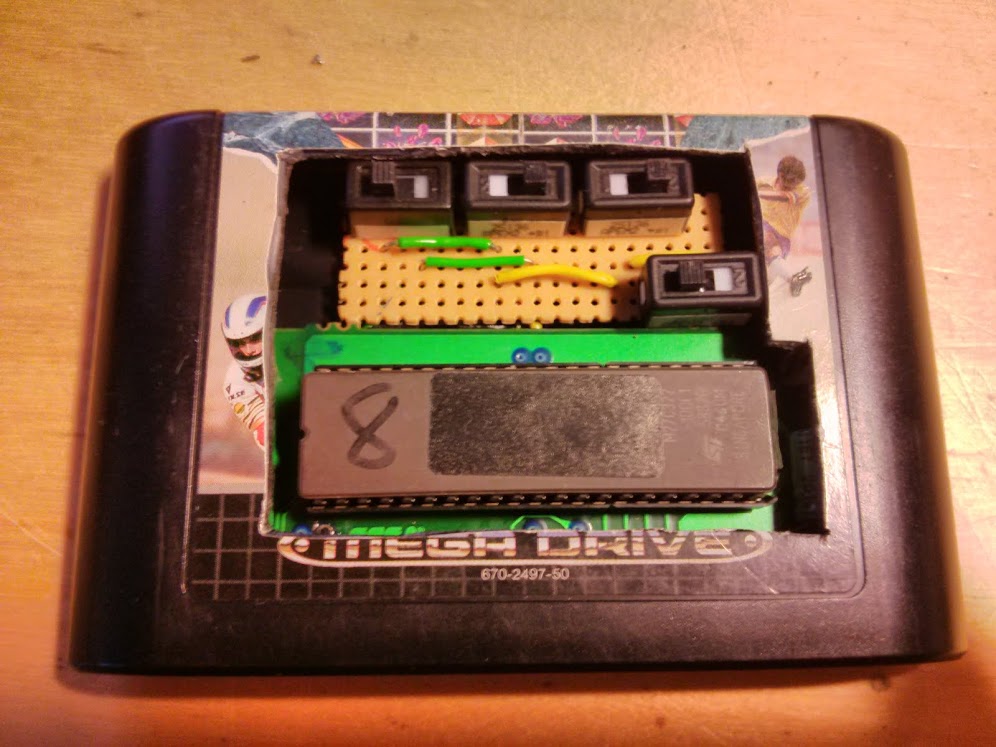

About £3 quids worth;
holds up to 8 games on a 32mbit 27c322 eprom, bottom switch chooses 4/8mbit games the other 3 are for address selection (ie game selection). works a treat
mihgt prettify it at some point now i know it works.
based on a guide here;
http://www.epforums.org/showthread.php?63960-GUIDE-Make-a-Reprogrammable-Genesis-Cart
I was going to try something fancy like a reset pulse generated counter and 7-seg display but by the time i figured it out id added 4 extra chips into the mix so decided to stay old school.
