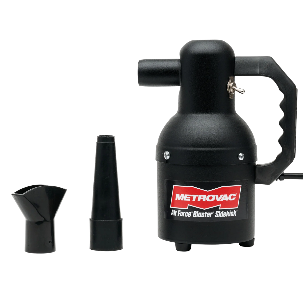

My method is wash in the bath with a slow flow rinse via a bath shower head and to dry off using a car air dryer like a metro vac
sidekick, this is great for expelling out any moisture from PCB boards especially under through hole mounted chips.

Water is fine but shifting it off the board in the quickest possible time is the key before oxidation or rust issues can set in hence using the Metro Sidekick is the cheapest and closest method of using compressed air on a PCB board.
