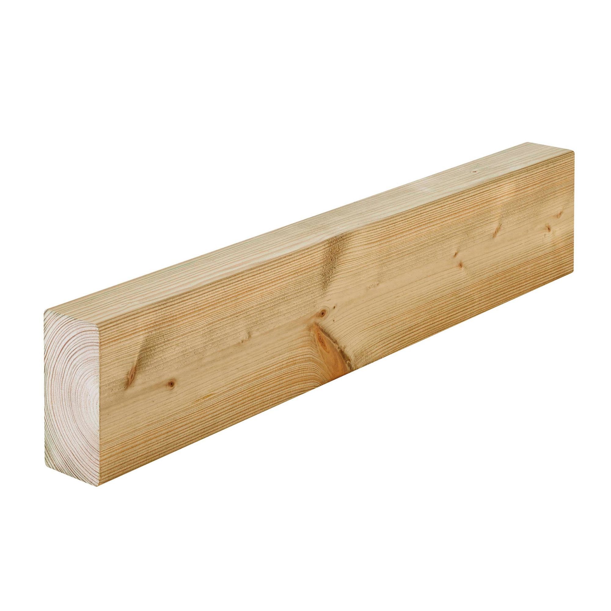

To be able to install the insulation, I would need some lightweight beams that go in the opposite direction to the false ceiling beams:
