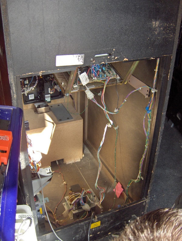

re-wiring should not be too much of a problem, just checked through my old pics and it looks like the power for monitor & marquee etc runs up the right hand side and the main Jamma loom goes on the left (looking from the back of the machine)
it should look something like this

ki2 is slightly different to a ki cab (uses a different psu setup) but mostly the same, i.e monitor loom is the same, not sure on the originality of that monitor you got in there.
that loom looks a mess, if you disconnect from the psu and the control panel and coin door it should come out you may need to transplant some plugs from the original loom too the new one though

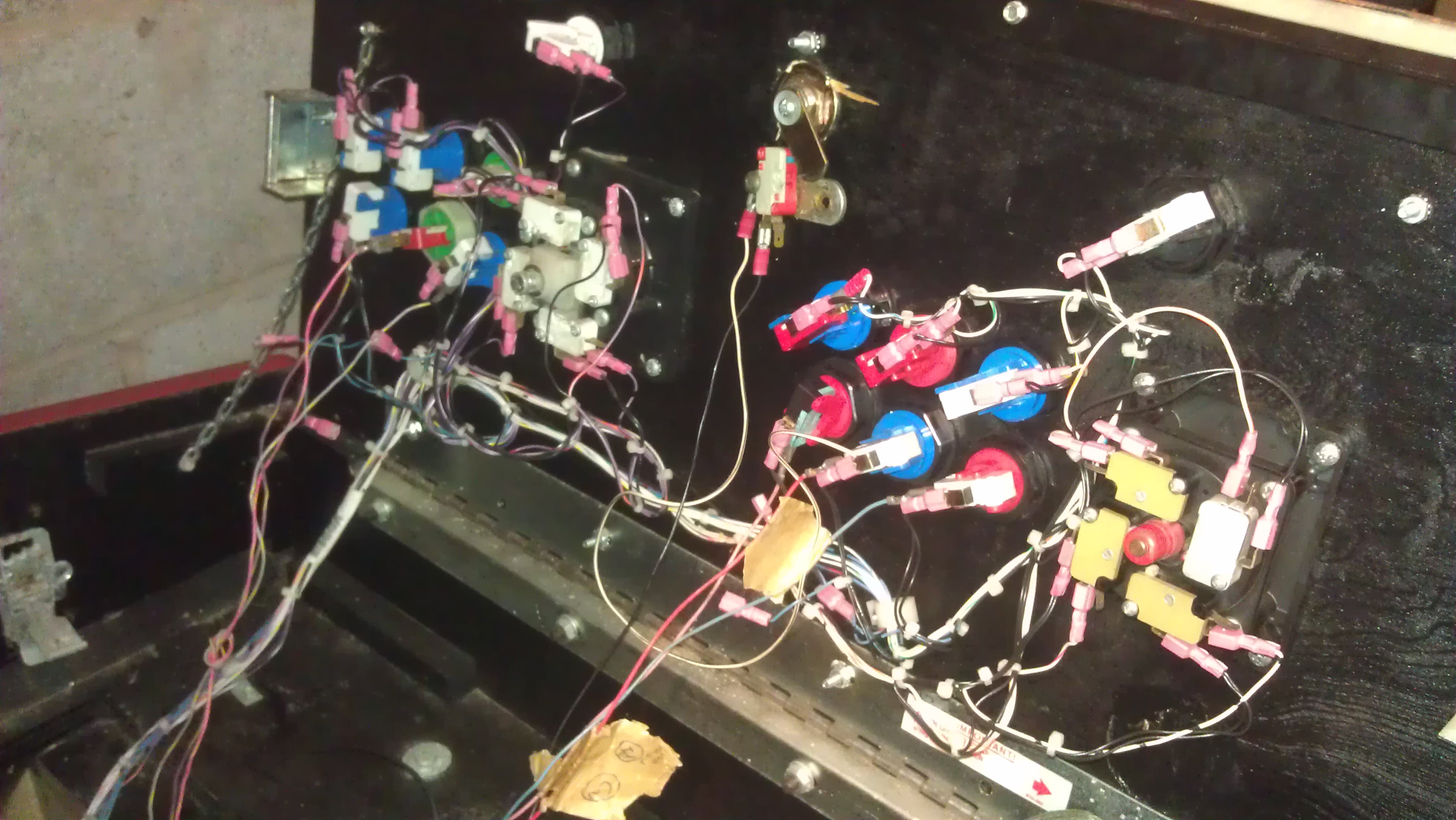

There are wires all over the shop, loads of spliced wires and all sorts of crazy stuff going on!

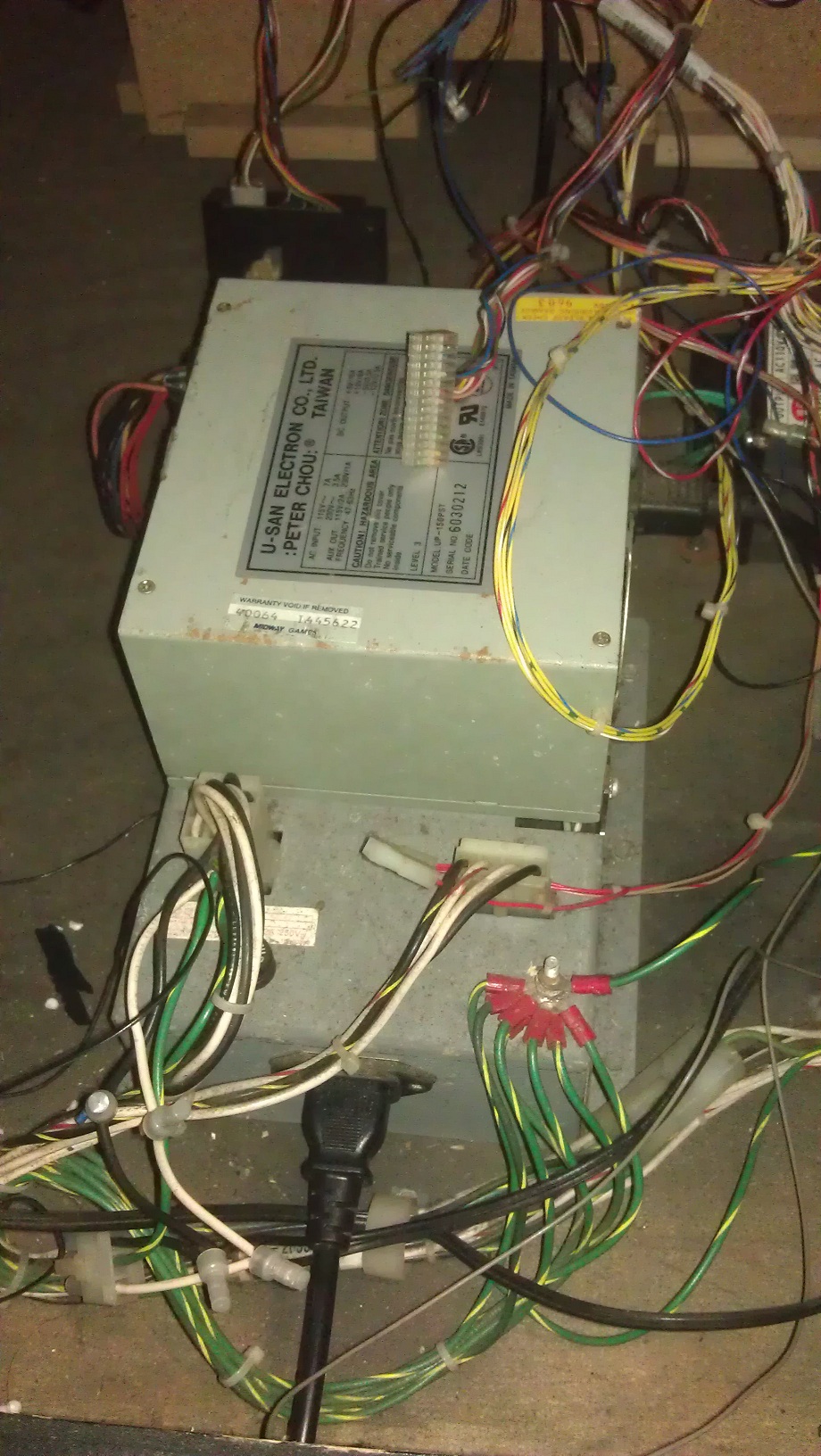

Got some touch ups to do on the artwork. Bit pissed off with the guy i bought it off, who, incidentally actually is registered on this site! He told me it was all working fine and showed it me running a sf2 bootleg, the horizontal sync was a bit out and i mentioned it and he said, oh you can just tweak that no worries. Turns out the h-sync pot on the board doesnt work! ! ! ! !And the PSU blew about a day after having it so bought a replacement from the states, and the wiring was death trap! so that took a bit of effort to get sorted!
