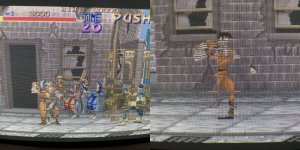

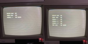

And then game booted ..sort of ... very wobbly/wavy picture at first and a 'no good' fail at 'SCROLL 1' but that cleared up with a voltage boost and then a 'no good' fail at 'OBJ RAM'
Which also cleared up with another voltage boost and the game started ...
You can see that the text layer looks fine, also appears there are 2 'background' layers with one working fine (background tile layer - skyscrapers) and the other corrupted (foreground tile layer - street, buildings etc). Also, the sprite layer is missing completely ..

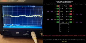

Made by everyone's favourite TTL manufacturer - Fujitsu. If you read online fix logs and watch videos you'll see Fujitsu TTL mentioned time and again as likely fail points and some people just swap them out soon as they see them. I've been lucky I think as I've not come across a bad one before ... maybe this is my first ... pretty confident it is bad but Sliced it to make sure ....
You can see the poor signal (on the left) and the confirmation it's bad from the slice result (on the right) below ...

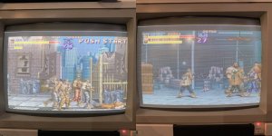

Cut that out and socketed in a new LS86. This fixed the FG tile layer ...

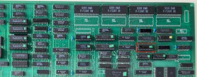

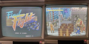

Focussing the search for the missing sprites in the area at the top of the board previously marked in green, in the area of Mask Roms F-FIGHT 00 - 03 and after a bit of probing around found something rather unusual about the socketed LS273 marked below ..

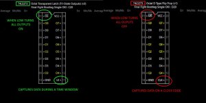

An LS273 - 8 edge-triggered D-type flip-flops, with a shared clock (CLK on pin 11) and an asynchronous master reset (/MR on pin 1)
When /MR = low - forces all outputs low regardless of clock or data. Think of it like this:
A row of 8 light switches that only change when someone rings a bell (clock). /MR is the master breaker. If the breaker is OFF, all lights are forced OFF — no matter how often the bell rings. So if the /MR pin is ALWAYS low - the chip is basically permanently turned off. And what would be the point of that ..
But as you can see here from the Slice of the chip ... the /MR signal is indeed stuck low, and consequently all outputs are also low despite inputs and clock all carrying healthy signals.
This implied an accidental short to ground on pin 1 and continuity confirmed it. Flipping the pcb over and looking on the solder side and you can see a tiny connection between the ground rail and the pin.
And it looks to me like it's intentional, which makes it very weird. It also looks like the chip was originally socketed too as the soldering is all very clean and original looking. Despite it looking this way I can't think of a single reason to tie that pin intentionally to ground by the board designers. So I broke the trace (hacked at it would be a more accurate description :)
This 'turned on' the LS273 and woke up some of the sprite circuitry ......

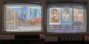

Anyway ... Progress on screen as we can now see in the pics above that some of the 8x8 sprite tiles and it looks at first as though tiles are either present and correct, or tiles are just completely missing. But sometimes tiles are rendering slightly out of position and sometimes have lines through them (below) Not that easy to see

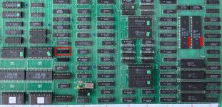

On the picture below I have red boxed the LS273 which I've now switched for a LS373 ... and just above to the right of it is a LS163 in a socket ......
Again, I take out the chip and underneath, printed on the silkscreen is LS163 .. but what if ..... what if it's not actually supposed to be an LS163 and like before, someone has put an LS163 in there because the silkscreen says so ... it's happened already with the LS273, why not here too .....
So I go researching for IC's similar to a LS163 with a slight difference .. and step up the LS161 ...
Both 4 bit binary counters that count on the rising edge of a clock signal, the ONLY difference is the reset on pin 1.. on a LS163 (chip in socket) the reset is only checked on a clock edge (synchronous), so even if the reset goes active, nothing happens until the clock edge checks it. But on a 161, the reset happens as soon as it's activated and does NOT have to sync (asynchronous) with the clock. This small difference can have quite an effect as sprite circuits are driven by video timing, have tight windows and must reset counters exactly at tile / line / sprite boundaries.
Certainly felt like it would be worth trying ..... so out went the LS163 - in went a LS161 .... and couldn't help but laugh when I saw this ....

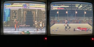

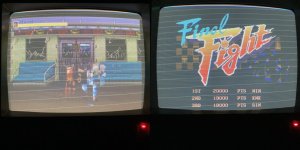

So all was looking good .... BUT then I noticed loads of random artifacting in the top portion of the screen, it didn't do it on any static screens, only gameplay and the more sprites on the screen the more of these small lines of random garbage. Popping the sprite line buffer rams out of their sockets removed all sprites from the screen (expected) but also removed all the artifacting ... so I knew this is still a sprite issue. grrrrrr. It was really difficult to get pictures of it because this graphics tile garbage flashed on and off the screen so rapidly but I've marked a few on the following picture ..... but there was loads more of them just the photo's don't really catch them, all in the top half of the screen. The more movement on the screen the more the random artifacting ....
And with this I definitely got lucky ... at first I thought ok maybe a chip on its way out, maybe actually one of the ones I put in, because I didn't notice any of this before when some sprite tiles were missing. I generally re-use TTL chips from donor boards so bound to have a few old and tired ones. Raiding my stock of TTL, I tried a few different 161's ... no change. Tried a few other LS373's ... no change. Then I came across a 74F373 and thought hmmmm this is a faster version maybe that will help, so put it in and it has cleared up all the little bits of garbage and now got a pixel perfect game !!!

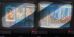

Another thing that's bugged me with this pcb is the image on screen has always had those (slightly diagonal) retrace lines that you get on your monitor when the flyback's 'screen' adjustment is too high. I'm not very clued up on crt monitors but I think that's basically a brightness setting?
You can see what I'm talking about on the picture below ... it's not always this bad, I picked a particularly bad occurrence to illustrate, but those lines are always there
So I looked at the pcb's RGB outputs and traced each signal from a LS174's ... the 4 outputs all go into a single resistor array (2.2k, 1k, 470, 220) and then one signal out, which goes through a 220 ohm resistor before hitting the jamma edge ... Vpp is 2-2.5v on the signals, which I thought was high, but I tested other bootlegs I've got and others have perfect picture (brightness) on the monitor and also have 2-2.5v ... either way I tried replacing the 220 ohm resistors with 470 ohm but it made no difference, well actually it may have even looked a little worse, in that the colours seemed dimmer but the overall washed out feel and the retrace lines were still there bright as ever.
So I put the 220 ohm resistors back. Not sure what else I could de here, if anyone knows what might be causing this or has any ideas to try to fix it please jump in !!
Just to clarify - this is the only pcb that looks like this on this monitor, so it's definitely this pcb ... probably just crap RGB bootleg shortcuts in design or something ...
