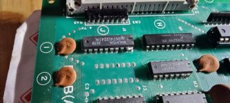

The Q and E clock signals that are required by the konami-1 CPU are generated on the video PCB from the custom at D1 but the reset is generated on the CPU PCB but passes to the video PCB then back to the CPU PCB. These signals go through the 244 at A1 and this is where they we failing so it looked like A1 was bad.
Now for some reason (either they had a surplus of 241s or a shortage of 244s) they used 241s to replace quite a few 244s on this PCB.
The main difference is the second enable on pin 19 is active high on a 241 where it's active low on a 244.
To cover this they cut pin 19 of the 241 so it wouldn't be held to GND and soldered it to pin 20 to hold it high.

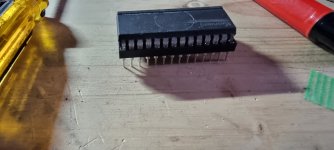

Now if I wanted to replace this with a socket I would have a problem since I wanted to use 421s to keep things he same.
I ended up removing the bad chip,cutting the trace that connected pin 19 to pin 1 (pin 1 was connected to GND to hold it low) then after I had fitted the socket I connected pin 19 to pin 20 on the underside of the PCB. I could then drop an unmodified 241 into the socket and have it work normally.

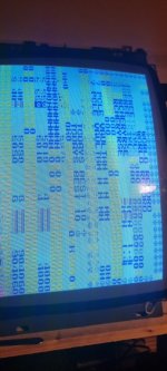

You can see the name entry screen here and the colours are moving but no proper graphics are showing:

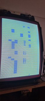

And then tried cutting the D0 leg on E9 and that sorted the signal out.

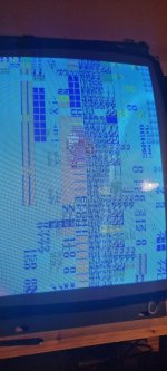

Replacing that gave me this:
Getting there.

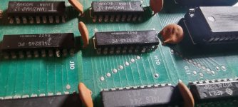

Turns out it was the 273 at C16.
Didn't figure it out in any technical way since what I thought would cause the issue wasn't actually faulty.
Ended up just shotgunning the sprite section with my slice,pretty sure I had checked that chip in earlier tests but now it was showing as bad.

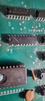

When I started to desolder it I could see why the issue was intermittent:
Two legs were corroded to the point of failing. I assume sometimes they were just about making a connection and the rest of the time (when the sprites were stuck to the left) they were disconnected.
Replacing that appears to have fixed the issue but since it was intermittent will have to keep checking to see if the issue rear it's head again.
