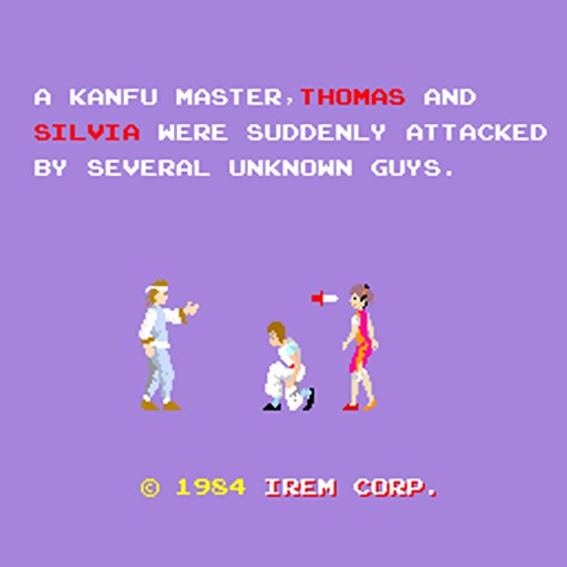

I have just been looking at a KFM board and I noticed that the intro called Thomas a Kanfu Master rather than a Kung Fu Master.
(Screen grab from running the ROMs in MAME.)
Upon checking the MAME (.232) driver I noticed that the notes still have this ROMset listed as missing and that the bootlegs were possibly derived from it. The program ROMs are labelled SNX-A-4D-A and SNX-A-4E-A and the MAME driver does not include this -A ROMset.
The good news is that I have dumped the ROMs, the bad news is that they exactly match the bootleg kungfub set already in MAME. SNX-A-4D-A matches c4.5k and SNX-A-4E-A matches c5.5h.
I have renamed them to match the World set and other than the intro, I couldn't see any obvious differences. Anyway, that's one less mystery...
