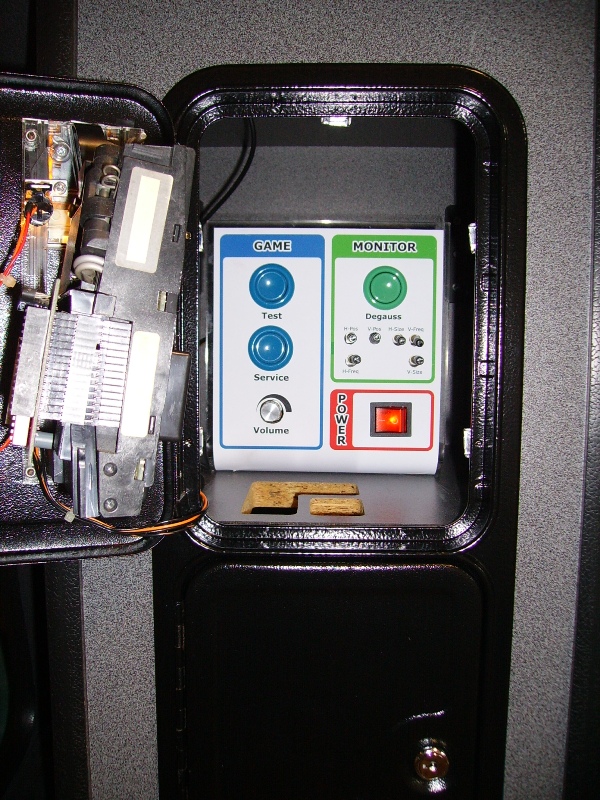

I made a little service panel for my two MAME cabs, which includes a little amp with volume knob. I just spliced in the amp to the speaker wires.

Big10ps solution above is far more impressive though! Like the monitor screen controls, is that the monitor chassis control board behind it run out on an extension cable?
Yes, that's the remote board controls. Comes in handy for tweaking the H Freq pot as I run games at their native res and frequency on groovyMAME and there's quite a lot of difference in horizontal frequency between all the games. Most games are similar though, so I don't have to adjust every time I switch games.
The cabs remain fully JAMMA so I can play original game boards on them. I just have to set the PCB amp to a minimum as amplifying twice isn't ideal, but it seems to work well enough.
