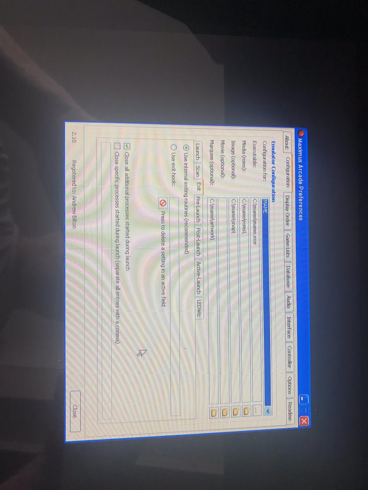

Note to self 17th October 2025.
In order to set Quit Executable to ESC as per last screenshot above you have to press ctrl and p together from a plugged in keyboard when Maximus Arcade is running to access the preferences screen be able to set it up.
If you close down Maximus Arcade and access the Maximus Preferences via the separate program, when you press ESC to set the Quit Executable field it kicks you out of the program (and does NOT set that field to ESC).
You have to press ctrl and p whilst Maximus Arcade is running to bring up the preferences screen and do it from there - and do not forget to save once changed!
