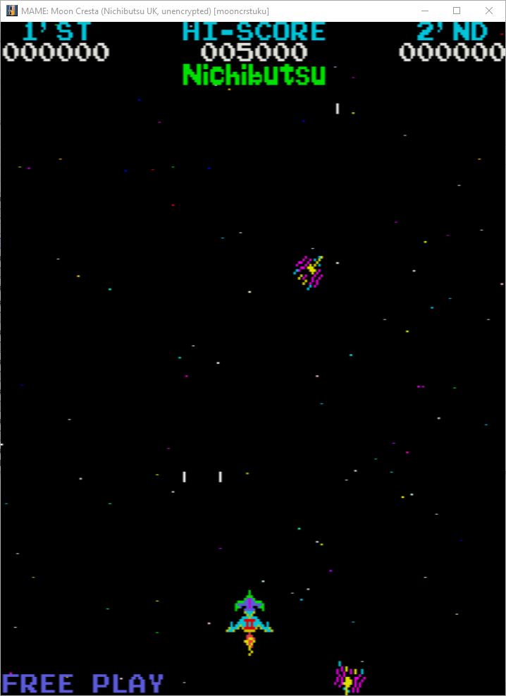

Whilst doing the high score save hack I noticed it's another game with annoying freeplay mode, where it sits at the "press start" screen rather than going through the attract mode. I decided to also do this modification (and been able to test in Mame) which is what the code below is for. Basically when in freeplay mode, it still displays "free play" on the screen, but now cycles through the attract mode. Just pressing P1 or P2 start, begins the game.
The hack has been done for the "mooncrstuku" ROMset, and as the addressing is different across different variants it will only work with that one. The code itself is simple so could be adapted to the other ROMs by changing the absolute addresses, so I've also included the source below.
