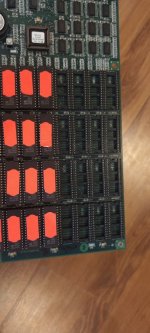

Hello, I'm new to the forum. I am looking for four dice with a program or just the program for the Jamma MK3 PCB.
The game is mortal kombat 3,
their pcb space is U110, U110, U112, U113, these are M27C801 chips.
yoganuggy
639CR
Hi Piotr, these will be in the mame romset. The rom name is mk3.zip
That board is midway wolf. Not all roms sockets are populated.
Also if your problem is a blank screen, it's usually either the battery or a dead u45 chip.
