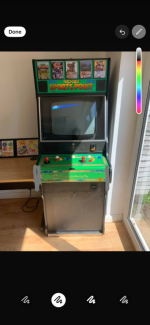

Hi, the C button on my Electocoin 6 slot MVS cab is having issues and for the life of me I can't work out how to open the control panel to have a look?! I'm sure it's right in front of me but any help would be much appreciated.

If you take the front panel off then put your hand in and up there is a catch on each side underneath the control panel one on the left and one on the right. Once you open those the control panel should be able to swing open.

Thanks for the quick reply.
I have had my arm up there and have no idea what I'm feeling for? Very little room for movement!
