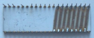

I can recall, quite a few years ago, Mike C stating that the ROMsets in MAME were decrypted and would not work with the CC1 IC. However, I have a ROM board with CC1 in place running Heart Attack and the ROMs match the MAME ROMset. At the time I thought no more of it.
After reading the text file in the above .zip, I decided to dig my boards out and have a look at rigging up the empty ROM board I have. When I got to the Heart Attack board I decided to have another look at it and discovered this...
The reason why the MAME ROMset works on this board is because the IC itself has been modded.
(I didn't notice the missing legs until I lifted it today.)
