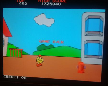

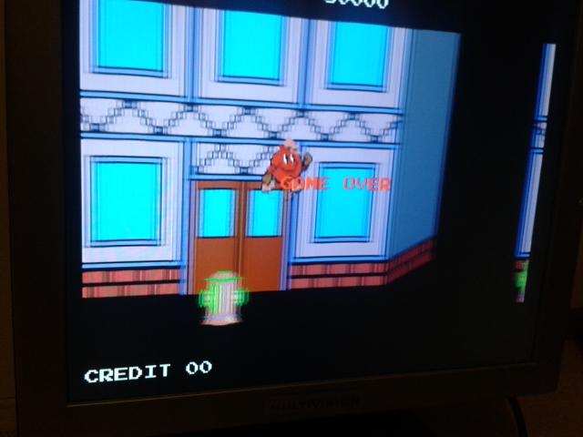

Symptoms are graphics not displaying correctly, with the colours of sprites and some text wrong; the scrolling background graphics weren't displaying at all (although the scrolling foreground was there, although the colours weren't always right)
Example pic:

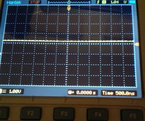

This chips are, in turn, driven by some 74LS298 2-to-1 mux chips. Probing these confirmed that the output at pin 13 of the chip at 2N was stuck high, but both of the corresponding inputs (pins 5 and 9) did have changing logic levels. Some scope traces below:
Pin 13 at 2N, stuck high (not very exciting this one!):

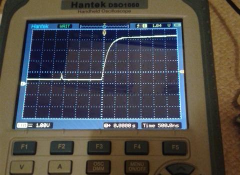

Clearly, there seems to be something wrong with the gate on this IC (the other gates are clocking through fine). But while probing I noticed that pin 10 looked a bit odd:
This is showing just over a volt - for a TTL input, that isn't very healthy, as it is in the "undefined" region between logic low and logic high. This traces back to the 74LS30 (8-input NAND) at 1N. The chip at 1N switches between the background and the sprites / foreground / characters, switching in the background when the foreground has a colour code of 127 or 255. The inputs to this again all seemed healthy, with traces similar to the input from CUS29 above.

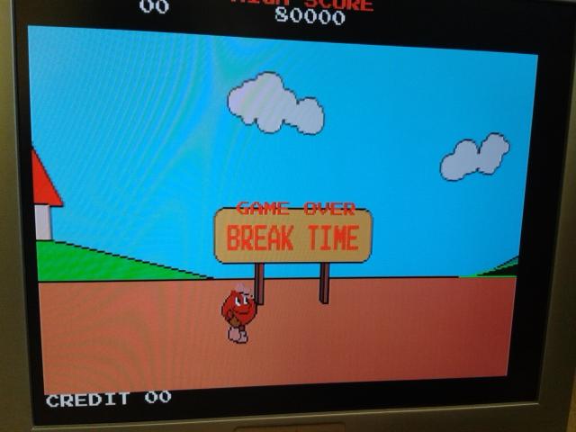

Well my local Maplins had a 74LS30 in stock so I couldn't resist popping down and having a go... my soldering skills are okay but I will admit I wasn't sure whether to have a go myself or pay someone else to do it! I decided to give it a shot, desoldered the 74LS30, soldered a socket in to take a new one, and this was the result:
The backgrounds are back! I will have to wait for the replacement 74LS298 to be delivered before I can see if that is the cause of pac-man's bad case of sunburn

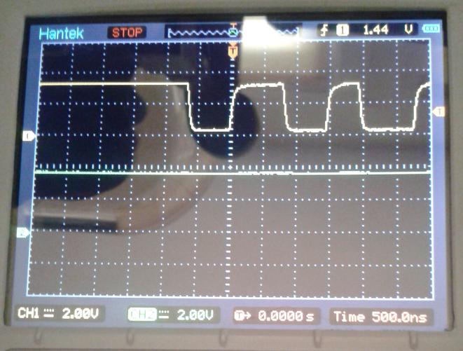

So here is a "good" trace, monitoring pin 1 at 2N as the top trace, and pin 14 at 2N as the bottom trace. This is a good trace - where we see a logic low at the top, we should see a matching logic low at the bottom. A logic high at the top would match with either high, low or changing on the bottom trace. (Sorry about the reflection from the window behind
And now we see an example of the pin that was playing up earlier - input pin 5 to 2N at the top, and output pin 13 from 2N on the bottom trace. Where the logic goes low on the top trace, it is not being correctly passed through.
It isn't obvious from this plot, but the output from pin 13 isn't always high - at other times it goes low, but it is clear from this scope trace that the chip output is not correct. This check can be applied to all gates on the LS298s at 1P and 2N, except pin 2 to 15 on 2N, which isn't used as part of the gate switching logic.
