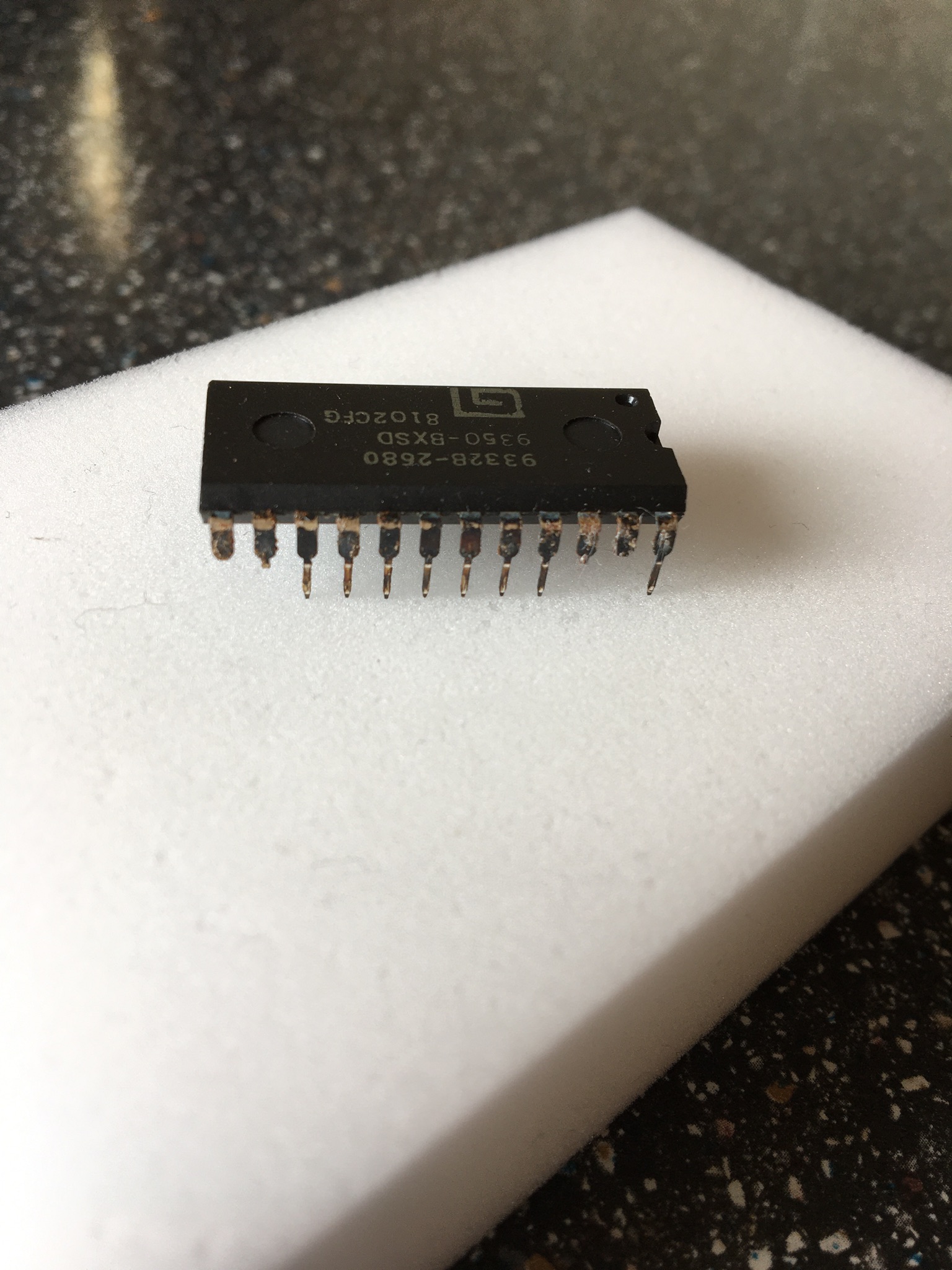

…so my first job was to straighten the pin back. Upon
further inspection I noted that the masked roms and Fujitsu custom chips had
some bad black tarnish and rust on them. It’s almost certain that these chips
are going to be suffering from the usual leg rot...

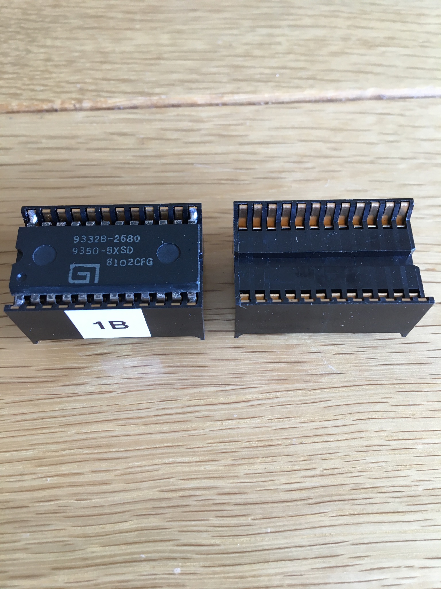

Also, when lifting the masked proms a lot of the legs broke off the chips…
I’m going to either have to get a replacement set of roms
burnt (probably some 2532’s with a slight modification to 4A on the board) or
try and salvage them. I’ve not got a facility to burn a set of 2532’s so I
opted for the latter and went about trying to repair them.
I purchased some deep 24pin sockets from a seller on eBay
with the thinking that the broken pins will still make contact with the side of
the socket. I gently cleaned all the contacts and pushed them into the sockets.
I used a multi-meter to check continuity between every pin and added a dab of
solder where needed to help make the contact between leg and socket…

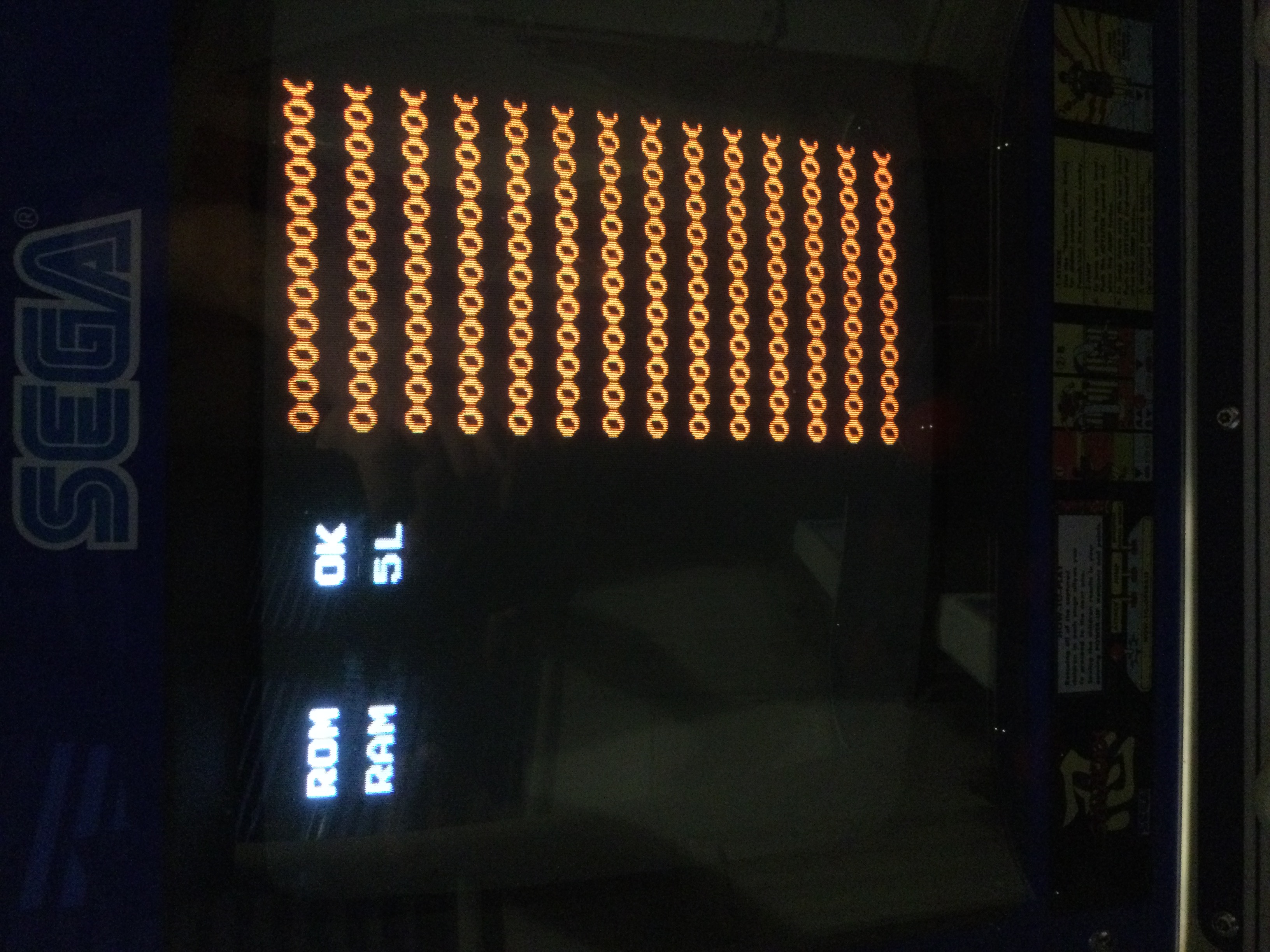

I’ve recently purchased a 2114 ram tester, so I decided
to check all 12 rams with it. One reported bad (not the one at 6N) so I replaced
it with a known good chip. Game still boots up to “ROM OK, RAM 5L” but there is
now a load of orange “0”’s filling the right side of the screen…

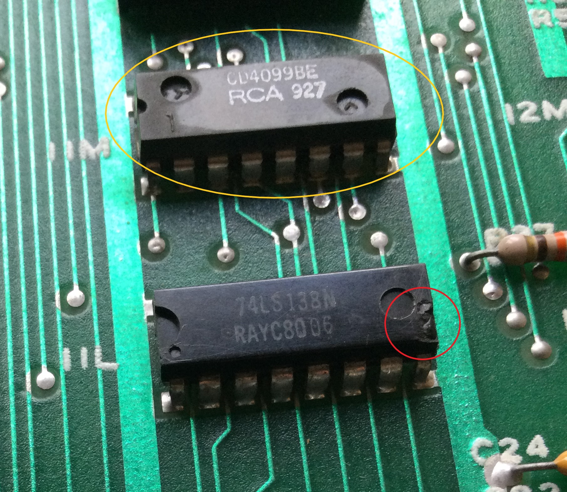

Back to physically examining the board sets. I’m looking
closely on the top video board and notice that the 74LS138 at 11L has some
slight physical damage to the top near pin 8 (circled in red). The 4099 8-Bit
Latch at 11M also catches my eye, it looks as if it’s suffered from some sort
of heat damage to the plastic (circled in yellow). Looking underneath the pcb,
I can see that the 4099 is one of the chips that has previously been replaced.
I decide to de-solder both chips, the 138 tests fine on
my tester, however the 4099 fails badly…
I fit sockets for both chips and fit a new 138 and 4099.

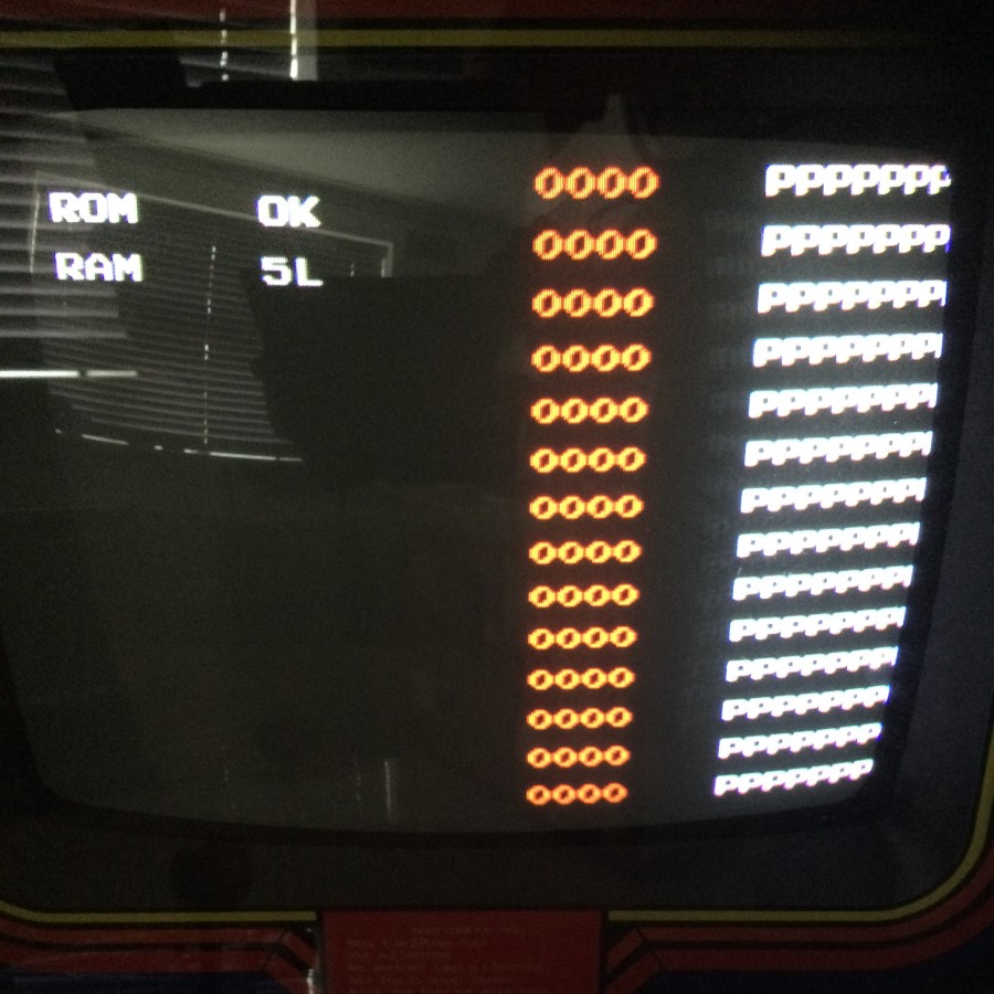

a 74157 at 2J. I decide to piggy-back a LS157 chip onto the one at 2H, this is
what I get onscreen…

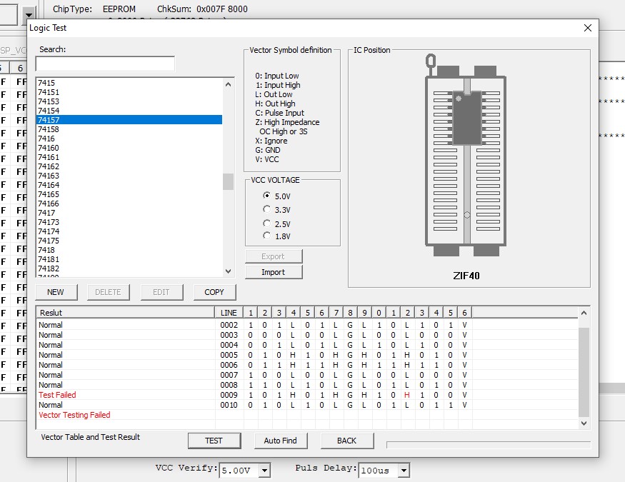

Interesting, there’s now a load of “P”’s onscreen, so I
pull the chip at 2H and test it. The chip tests bad…
With a new 74LS157 chip fitted, the game still boots to
the Ram 5L error, however the orange “0”’s have gone and there is now a
continuous sound pitch coming out of the speaker. There’s 4 other 74157’s on
this bottom pcb of the same batch number, so I pull them all to test. 3 were
good, but the one at 3K also failed. I replaced that and the sound pitch has

Re-plugged the board set back in and turned it on. I’m now
getting a black screen with “ROM OK, RAM 5L” flashing error in white text. The
manual states that 5L is the ram at 6M but I remembered that the manual was
wrong. Midway later issued a technical bulletin and there was an amendment to
the ram positions, and sure enough error 5L is actually the ram at 6N. I
replaced the 2114 ram at 6N from a known working chip borrowed off my spare
Elevator Action stack but it didn’t make any difference. I also tried swopping
the 12 ram chips around but again it made no difference, still getting error 5L.
I came to the conclusion that the ram is probably fine and there is something
else wrong here. I also swopped the Z80 with a known good processor and again
this made no difference. Checked for the clock signal on pin6 and also the
reset pin26 (high) on the Z80, both were fine.
now gone, but the Ram 5L error still persists!
