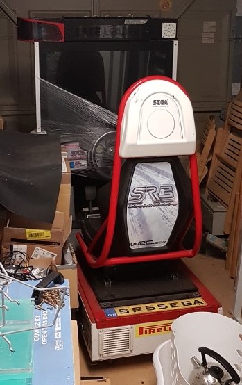

Measured it and it was 4" too wide to fit through the door into my games room - so job number one, remove the monitor and marquee so it'll fit through the door.
after a bit of head scratching as when I removed the nuts holding the LCD panel case in place it wouldn't come off I resorted to undoing the bolts that connected the marquee to the rear red poles and undid the four bolts that held the top of the dash on - result the whole top bit comes off!

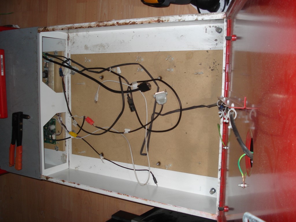

After a bit of cab Tetris to get it into the workshop/games side of the garage I'm ready to check what's there give it a quick clean and re-assemble what I can.
I'm basically going to check what's there give it a quick clean and re-assemble what I can.

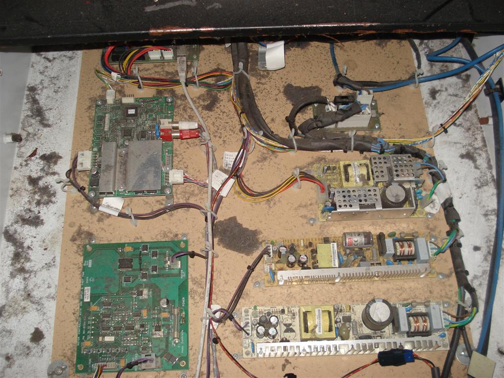

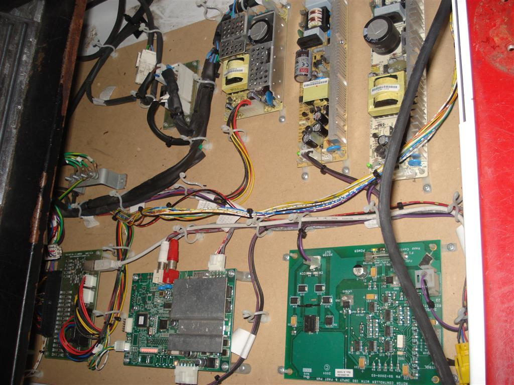

First up the PCB tray under the pedals.
Looks promising - no loose wires and everything seems to be there, I'll need to get a brush & hoover on it.
1) Feedback motor controller - looks like a standard Happ 270 FFB PCB
2) Stereo amp - standard Sega 2-channel amp, no sub-woofer output
3) Sega i/o board - Hmmm that's not JVS, on closer inspection its a USB i/o PCB (Sega version of an A-Pac)
4) Power supplies - All present and correct, Amp, FFB & I/O PSU's
5) Cables to Europa-R PC - USB for pedals/wheel/handbrake/buttons, VGA for screen, 2.5mm jackplug for audio & Printer port lead for FFB
So Everything's there apart from the Europa-R PC, PSU & rear cooling fan.

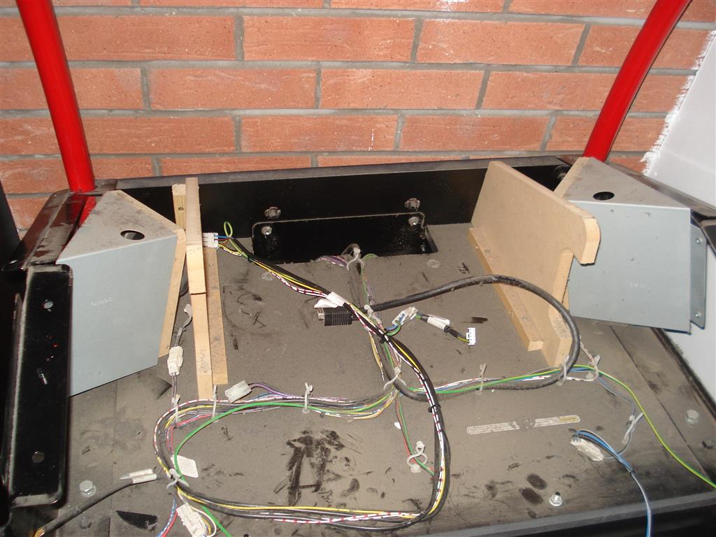

Turing my attention to the outside of the cab there's some obvious bits missing, and the rear door on the screen mount was bent & hanging off so that set alarm bells ringing.
After a good 3-4 hours cleaning the crap out of the cab and checking there were no loose nuts/bolts/washers inside and that it was earthed, correct voltage, fused & electrically safe I reassembled the main body of the cab (minus some trim - see later).

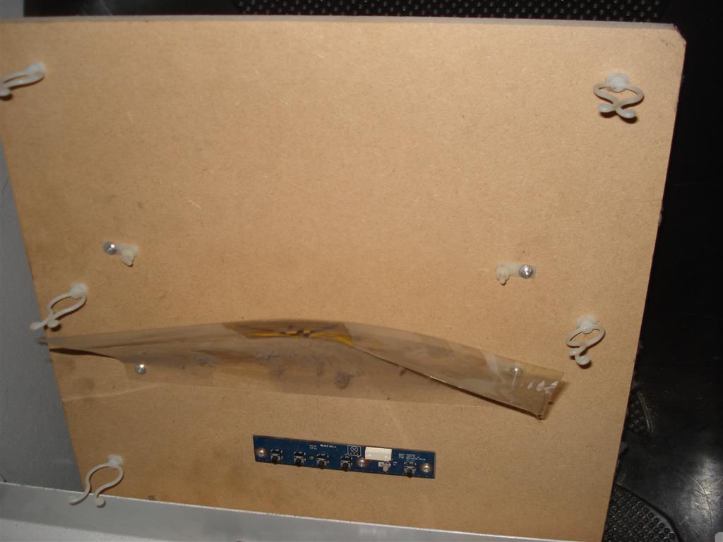

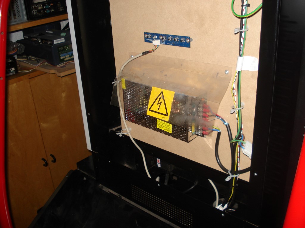

3) Power supply for the 32" screen
4) Europa-R PC

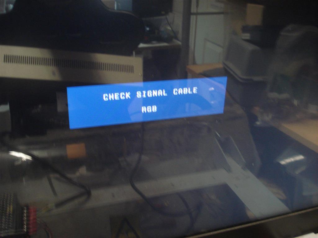

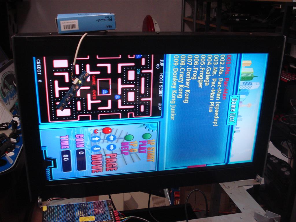

Lets fix the easiest bit (and more importantly find out if the screen works).
According to the manual the missing PSU is a 400-150-024-01 which is a "SW regu LPP-150-24" and is 24VDC output. I assume the 150 is 150W so it's a 24V @ 6.25A PSU.
I purchased a MW T-180-24 from eBay and made an adapter so it'd fit the existing loom.
Fired the screen up and fed it a test signal and it worked first time.
Not the best of tests - but it works, downside is when I used my laptop the panel only goes up to 720P.

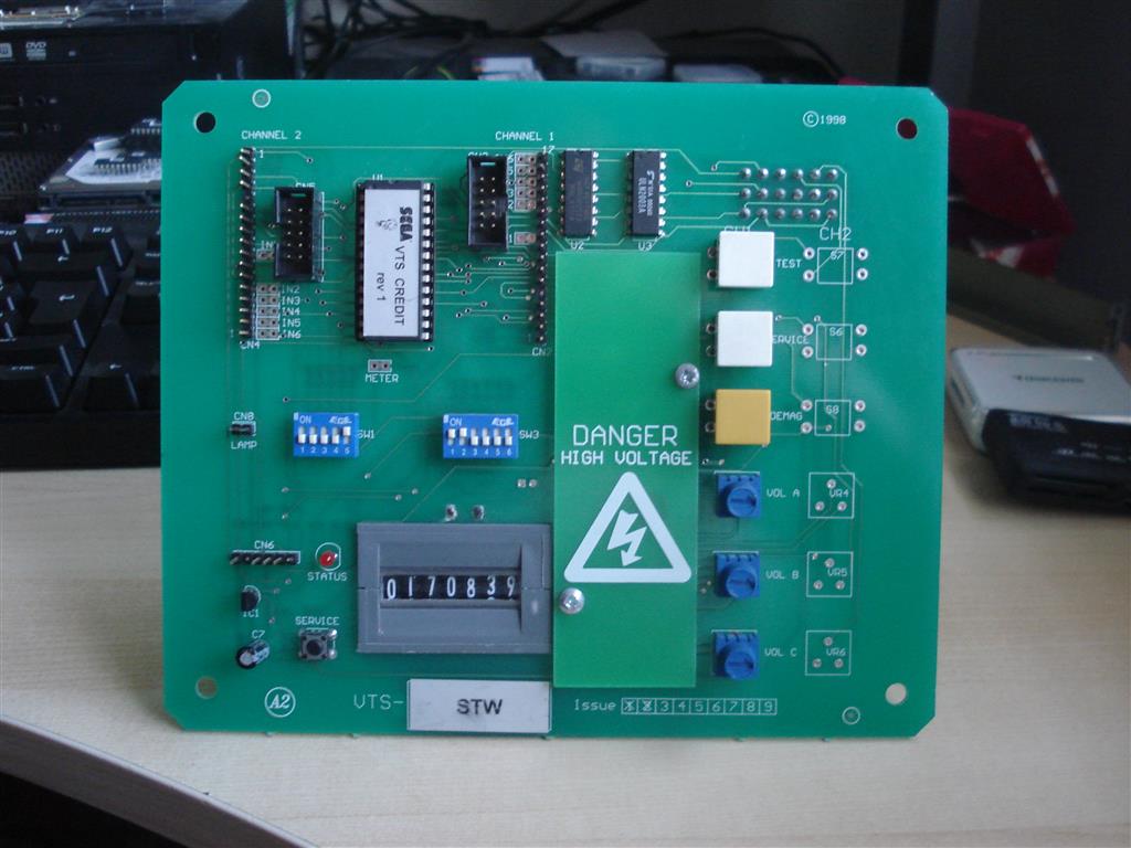

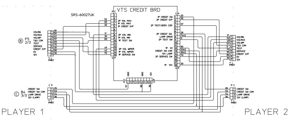

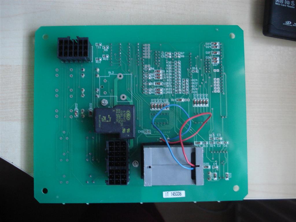

As you can't do much without a VTS PCB (even the speakers don't work) the next Job is to wire one up. This is where I struck it lucky - I had a single VTS PCB, I don't even know where I got it from but I had one in the bits box, then...Bummer

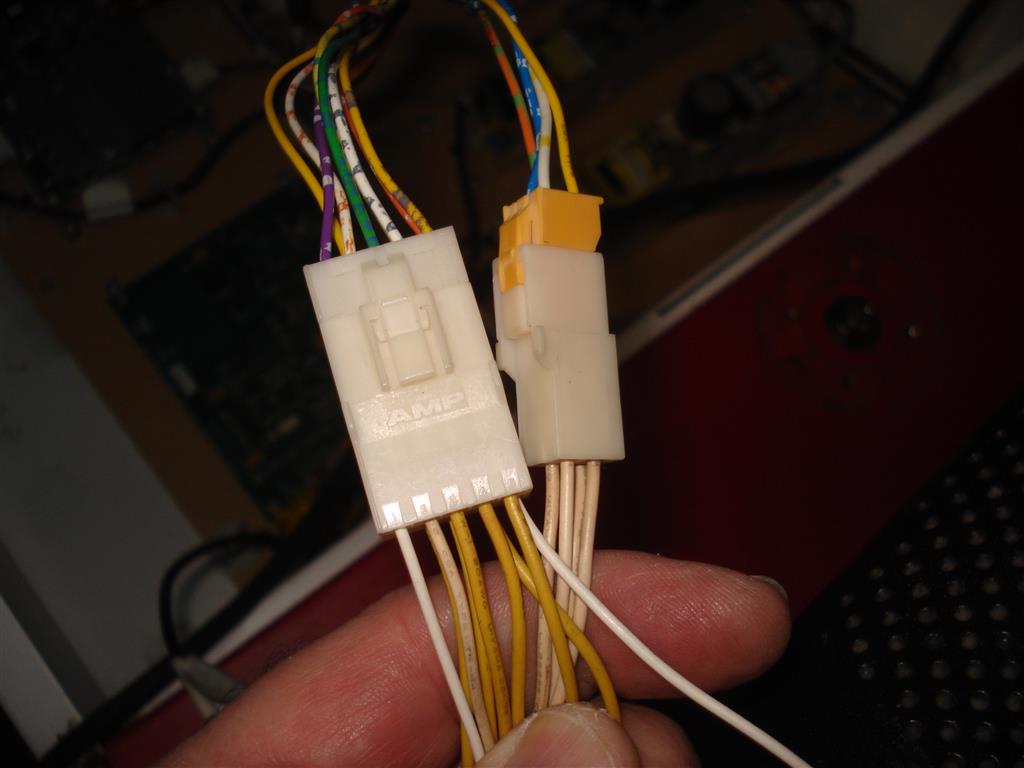

The VTS PCB wiring looms were missing, and nothing I had would fit the plugs in the cab. So delve into the bits box for some connectors that would fit and a bit of googlefoo.....
I downloaded the Sega Rally 3 manual and skipped to the schematic at the end.
Which I've compared to the pin out from AO (Initial D VTS PCB).
VTS 18-pin
1
2
3 Vol C - VCC
4 Vol C - VOL
5 Vol C - GND
6 Demag
7 Demag
8 Test
9 Service
10 GND
11
12
13 VOL B - VCC
14 VOL B - VOL
15 VOL B - GND
16 VOL A - VCC
17 VOL A - VOL
18 VOL A - GND
VTS 15-pin
1
2
3
4 VOL A - GND
5
6
7
8
9 VOL A - VCC
10 TEST
11
12
13
14 VOL A - VOL
15 Service
VTS 9-pin
1 GND
2 VOL B - VOL
3 VOL C - VOL
4 VOL B - GND
5 VOL C - GND
6 GND
7 VOL B - VCC
8 VOL C - VCC
9 +12V
So my adapter needs to be wired:-
Cab 4-pin goes to 18-pin only.
1-1
2-13
3-8
4-14
Cab 9-pin goes to the two other connectors.
9-pin.
4-1
8-6
9-9
15-pin.
1-9
2-4
3-14
5-10
6-15
7-5
Plug it all together and hopefully it'll work.

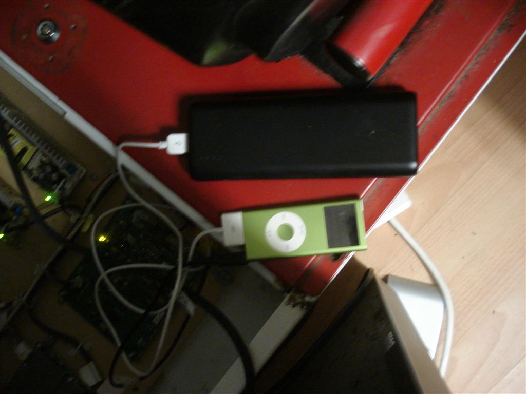

So what happens when I power it up?
Not a lot... Which is good, the power in the garage stayed on (always a good sign) and there was no puff of smoke, smell of burning or any other signs of woe. As I didn't have anything to drive the screen plugged in it remained blank, the FL tube in the marquee flickered but wouldn't light, tried another tube & starter - still nothing so it's probably dead, I can replace it with an LED one later....
So out came the trust old iPod mini, plugged the 2.5mm stereo plug in and pressed play - very quite music started playing, turned the pot on the VTS PCB for volume #1 and it got louder - Yes, my loom works and the amp does too. Just the i/o & FFB to test.

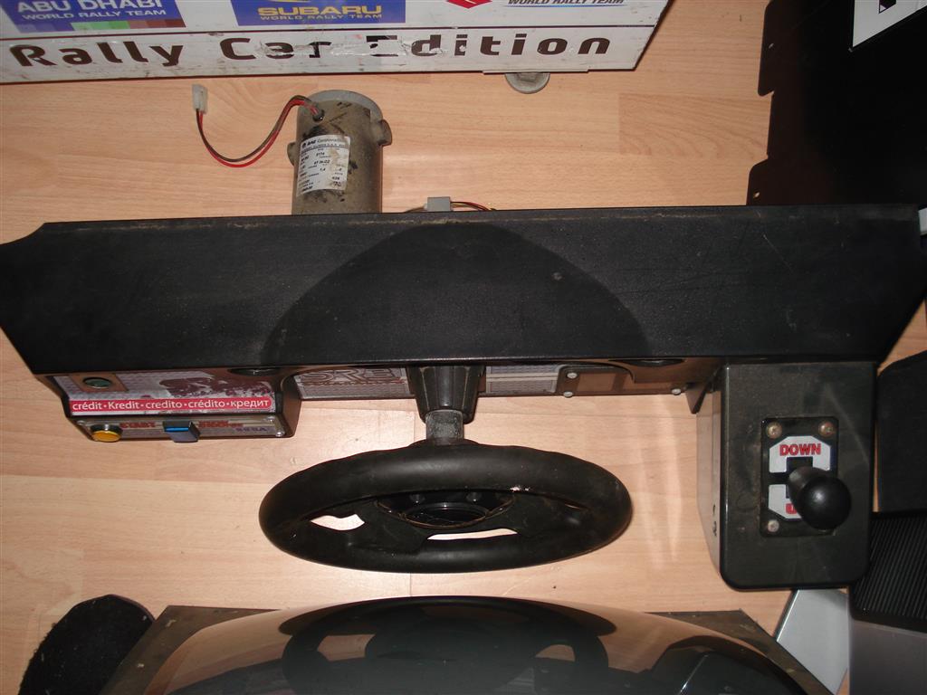

Gave the dash a good clean and refitted it (the Credit button was missing so I took the dremmel to an old starpoint button and trimmed the lugs so they would fit the small spade terminals on the loom.

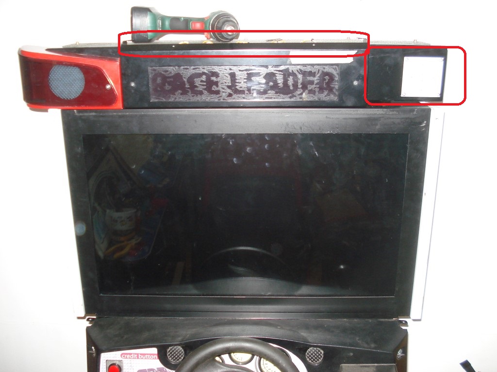

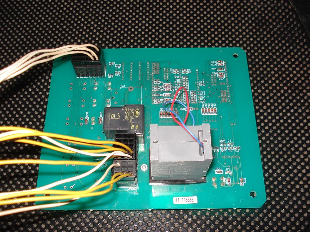

Noticed another bit missing - there should be a metal plate covering this hole. And the Light unit too (Both NLA from Sega parts).
This was about the time Sega support dropped a massive clanger by releasing Daytona USA 3 to the public on Dropbox.
I got the Download the day it was announced and was playing around trying to get it working and found a thread (since deleted) on BYOAC where people were hacking the exe.
As I had a PC the correct spec I thought I'd have a play, I followed the tutorial on how the edit out the dongle protection and what you needed in the ini files to get it running.
The PC wouldn't fit in the base of the SR3 so I poked the VGA, USB, Printer & Audio leads out the hole where the coin tower connects to the base and stood the PC next to the cab.
I didn't expect much but - running the setup program displayed exactly what you'd expect and I could calibrate the wheel, pedals and test the buttons, more than that the lamp tests made the correct lamps light on the dash & the headlights flash. The VTS PCB could interface back to the setup program too so I was finally happy that the io PCB was working.

Cosmetically - One side pod I've repaired the other needs some serious fixing, the missing metal plate is annoying but I'll get around to making one up at some point and I haven't a clue how to get a replacement light cover for the top right corner.
So information I need:-
Anyone got the measurements and a picture of the missing metal plate that fits above the "Race Leader" light?
