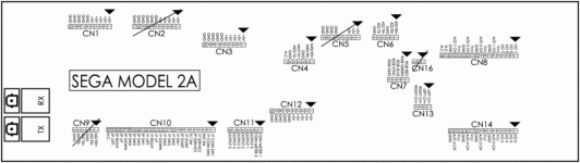

On the Model 2A pinout image you posted, the pot / analogue inputs are on CN8.
Pin 1 is on the right-hand side of CN8, where the black arrow is. The numbering goes right to left.
CN8 analogue pot pins​
Analogue channel+5VPot signal / wiperGND
A/D 1Pin 5Pin 6Pin 7
A/D 3Pin 8Pin 9Pin 10
A/D 5Pin 11Pin 12Pin 13
A/D 7Pin 14Pin 15Pin 16
So to check a pot input:
  1. Meter on DC volts.
  2. Black probe to the relevant GND pin.
  3. Red probe to the relevant A/D signal pin.
  4. Move the steering / pedal / pot slowly.
You should see a smooth voltage sweep, roughly:
  • near 0V one way
  • around 2.5V middle
  • near 5V the other way
Example for A/D 1:
  • Check supply: CN8 pin 5 to pin 7 = about 5V
  • Check pot signal: CN8 pin 6 to pin 7 = variable voltage as the pot moves
If the voltage changes smoothly at CN8 but not in the game’s input test, the fault is likely on the board/input ADC side. If it does not change at CN8, it is loom/pot/5V/GND related.
