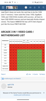

I'm starting to believe that the issue is that my motherboard not being capable of running Linux. Which is unsetting as I've read here that the DQ965GF is compatible.

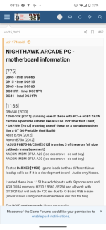

They was a compatibility list posted here, also someone said (here it maybe elsewhere, can't remember) that any D865 or D965 motherboard would work.
I still haven't fully given up on that the D965 yet, hopefully another version of SSB or an older bios will be compatible?
See attached pictures

I've picked up a DG31PR motherboard from eBay for £12.50.
This board is specifically mentioned on here so hopefully this will get me up and running.
