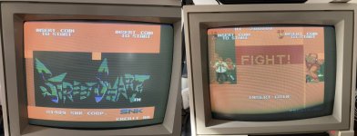

Gave the board a good scrub and removed as much corrosion as possible, checked all the ROM's and only one didn't ID correctly - number 6 ... rather than burn a new one I borrowed the same rom from the other board/version (A7008) of the game that I got which checked out good. (I think only ROMS 1 & 2 are different in versions 1 and 2). So with a clean board and all good roms, fired up the game ...
Obvious graphics issues, still no sound ...

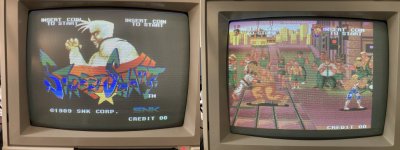

Found some damage to the solder side of the board, a gouge which has taken out 2 traces meaning a loss of continuity between a couple of LS153's and a couple of other IC's under the ROM daughter board...
Repaired these traces which had a big improvement on the graphics issues ...
Looks like the sprites are all back but the colours look wrong ..... so I checked out the 2 palette rams (6116) at C4 and C5, all address lines and data lines had seemingly healthy signals.

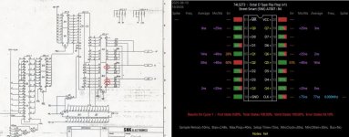

Thankfully the partial schematics for this version includes a page on the colour circuitry ...The data lines from these 2 rams go into 2x LS273 flip flops at D4 and B4 ... All signals in and out on D4 seemed good, but when checking B4 I found a few output pins with stuck signals while all inputs were toggling. Sliced B4 and it failed as expected....
Replaced the LS273 at B4 and colours fully restored (y)......

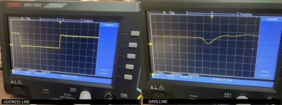

Since the Z80 appeared to be running, I suspected bad instructions or bad data. The Z80 fetches its program from a 27C512 ROM and uses a 6116 SRAM as work RAM. Out came the scope … address lines all looked healthy but the data lines not so much ….
The ROM had previously been dumped and verified so I knew the ROM data was good. Popped it out the socket and the dodgy looking data signals were still present on the sockets pins. This ruled out the ROM and left the Z80 and the 6116 SRAM as prime suspects corrupting the data bus.

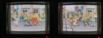

Obviously went with swapping out the RAM first and thankfully this turned out to be the faulty component. Replaced with a socket and good known 6116 and the game has full sound again. Hooray! So just a bad 6116 work RAM (at C15) killing the entire sound circuit.
Shame I went down a bit of a rabbit hole with the D7759 sample chip. Assumed it must be faulty as it wasn’t oscillating but just didn’t understand how that chip works, now I do I won’t make that mistake again. Took me ages to replace it as well because this board is an absolute nightmare to de-solder from. I had to cut it out in the end and ultimately didn’t even need to, it was fine 😖😖😖😖
But all’s well that ends well and that’s this one finished, even replaced the little red +5v power LED that had broken off during repair (taken from a SNK mechanized attack donor board) so everything is fully working again (y)
