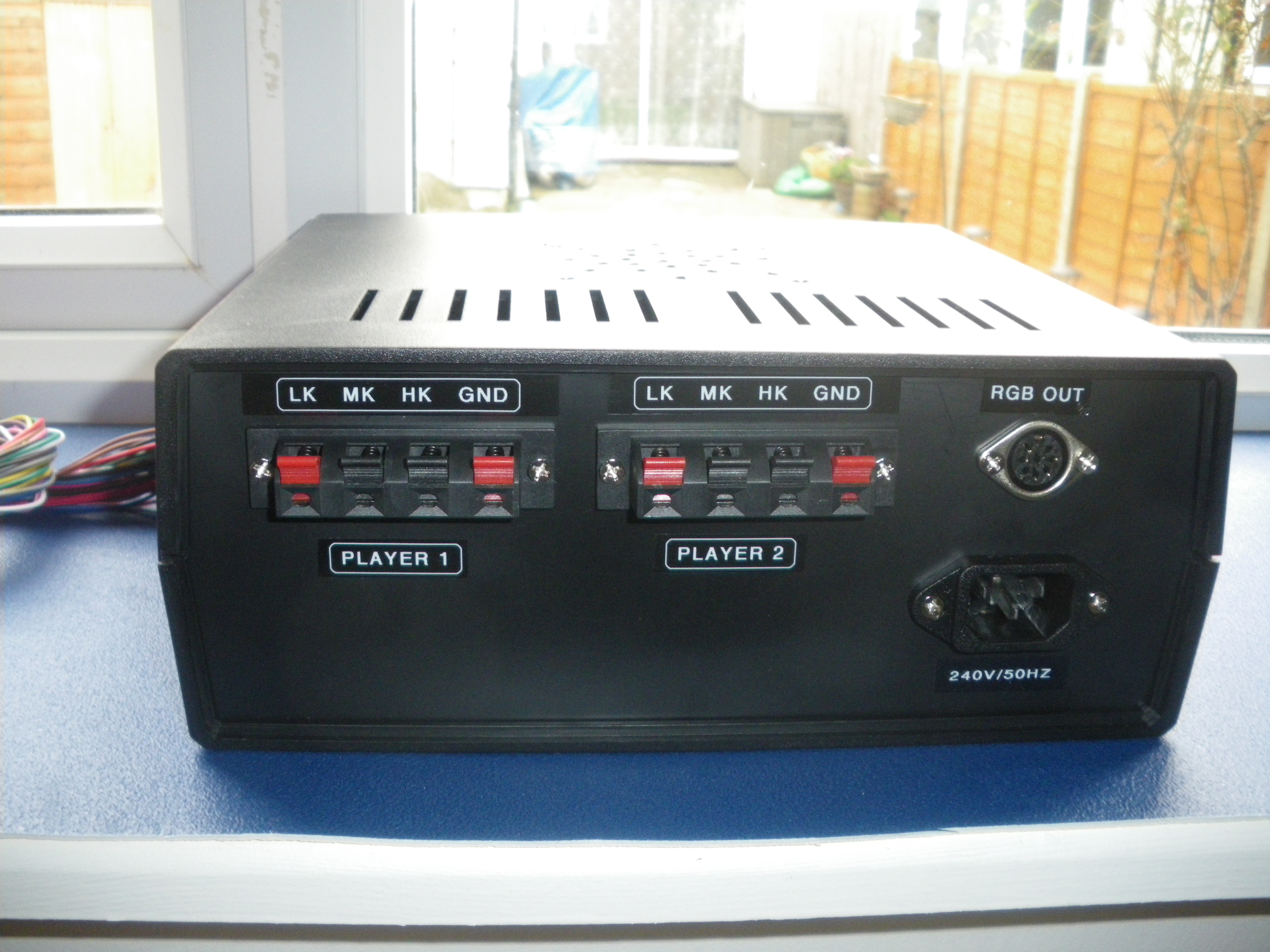

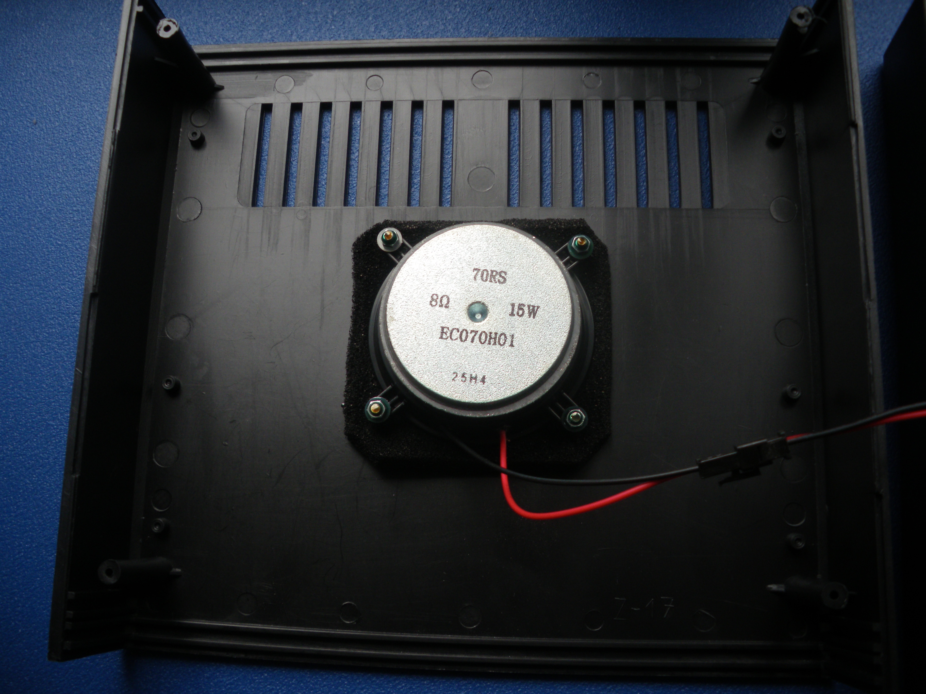

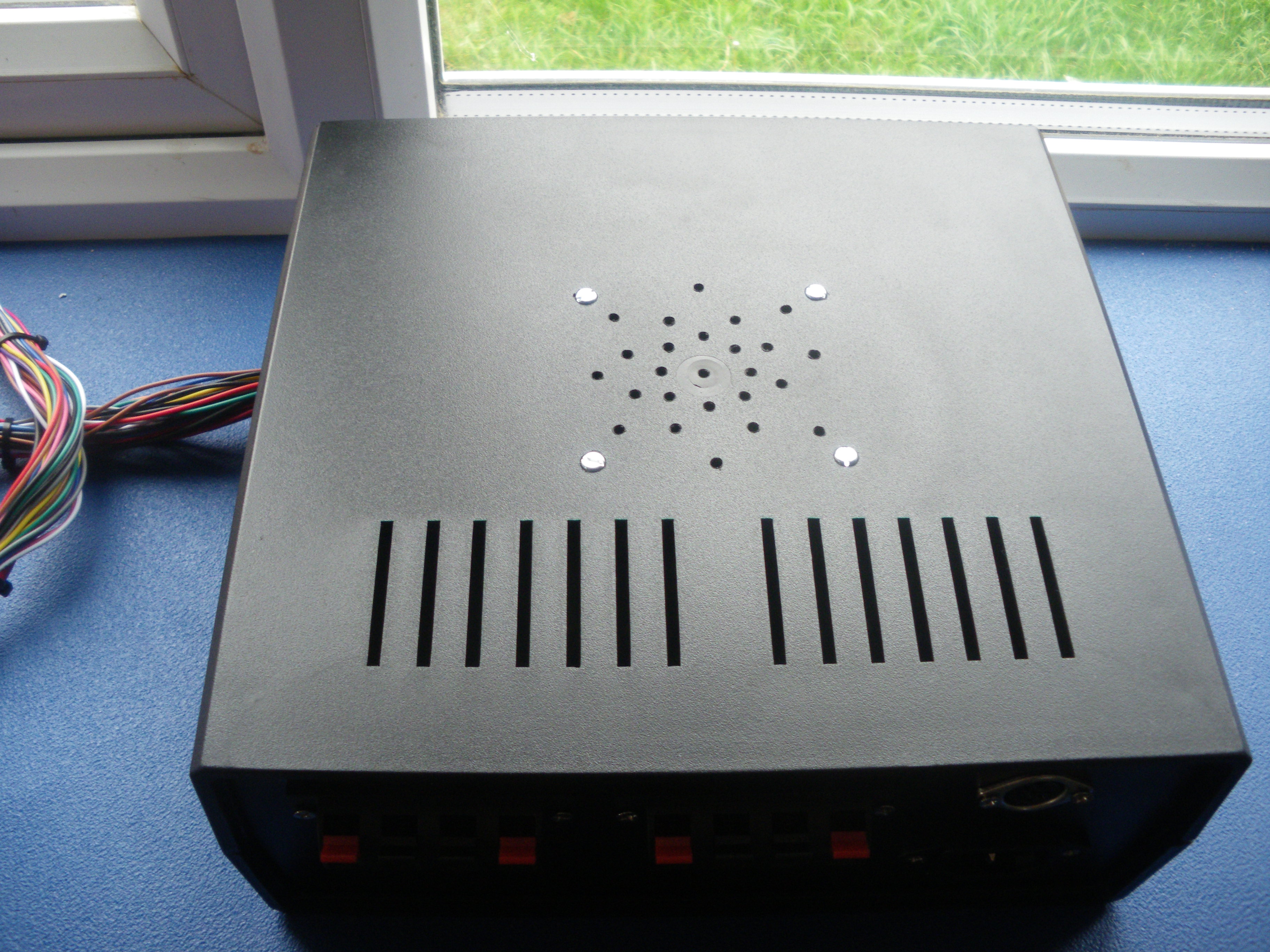

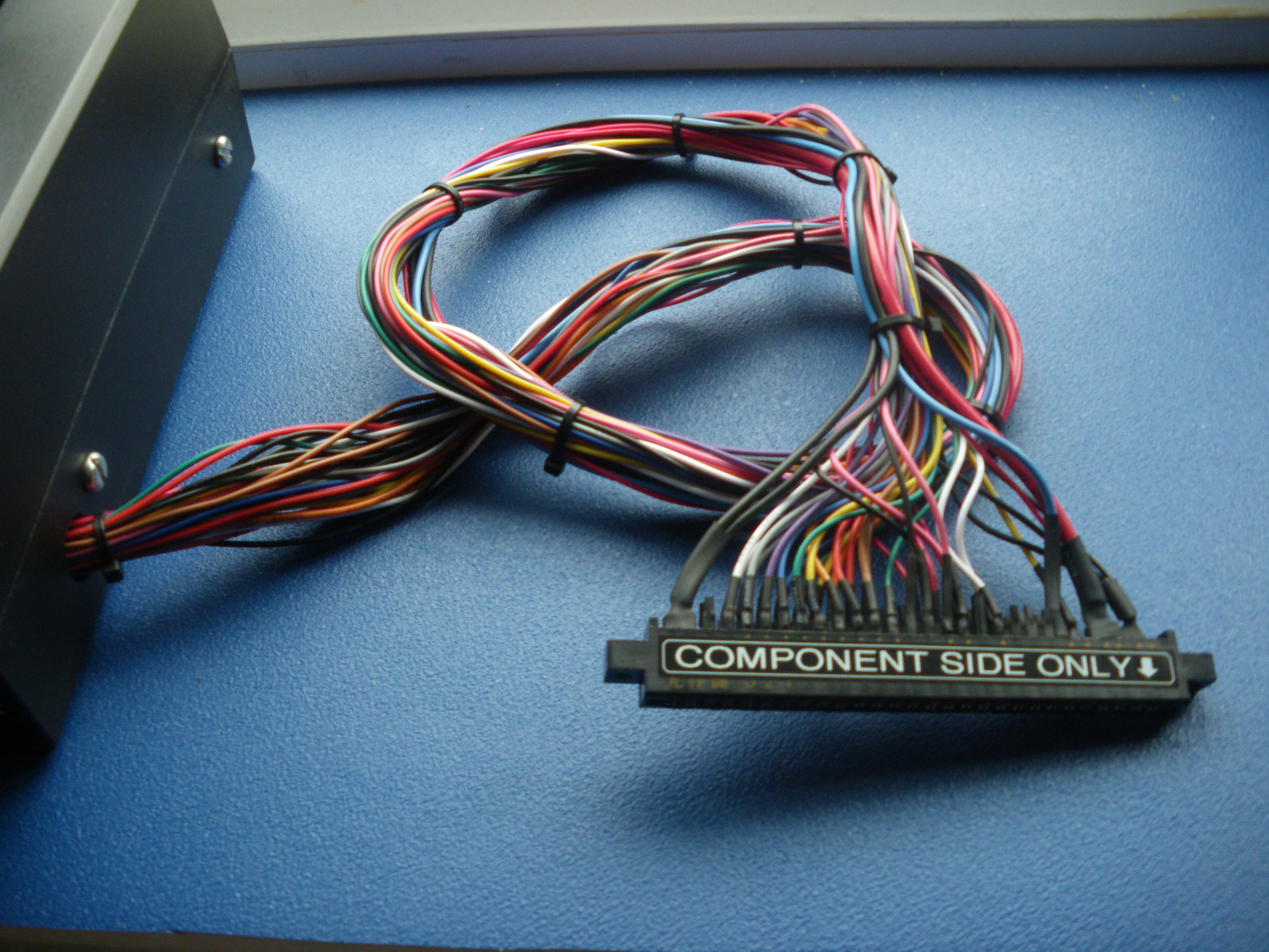

been working on building a supergun and pleased to say it is finally done,it has some nice features built into it,take a look at the pictures.

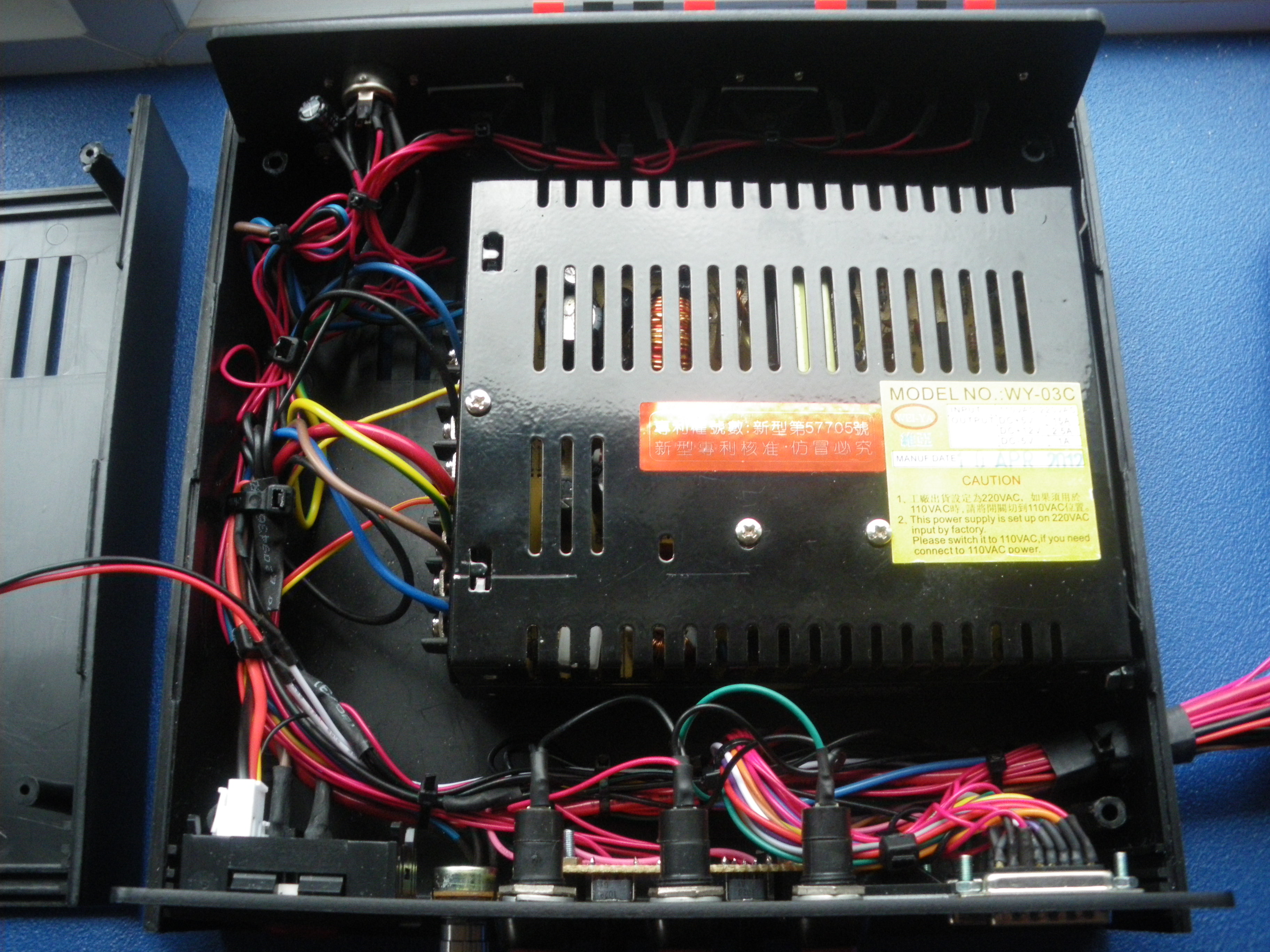

Hi,the smps pot was desoldered and removed,a new one I purchased which was a panel mount type was fitted then wires were soldered to the pot and there ends were soldered to the smps pot locations.
