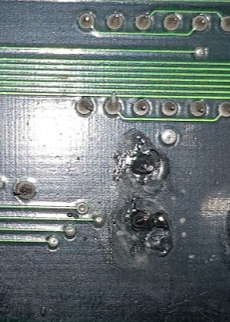

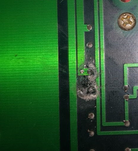

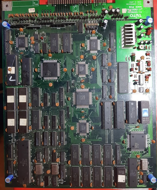

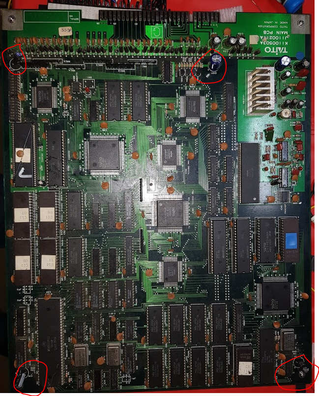

Ok so a quick look over the board and it seems someone has had a go at re capping some of the board and made , sadly , a rate mess is doing so. First off these boards are a NIGHTMARE to recap so to be fair they tried there best. I assume they attempted to recap to fix the graphics issues. I have circled the caps that had been replaced but its does not show how bad they actually were.
A couple of the bottom , Looks grim :-
The board looks in reasonable nick but has had a wack to the top right SMD IC24 - So first job was to fix this. I bent the pins back the best I could and re soldered them. These never go back straight unless you completely remove the chip bend pins back and replace. I dont like doing tis unless 100% necessary as it can cause issue and is not easy. I was happy with the work.
Fired the board up to test and no change in graphics. After running the game and pushing on IC57 I noticed the image got better , Not gone but better so I suspected that this was the fault. I hate reworking SMD ic as its very hard and my eye are prety much knackers , But hey ho had to be done !!
After re-working both sides and checking that I had not bridged nothing (You need a microscope else you have no chance of seeing it with the naked eye), I dont have the best microscope but its good into for me to check.

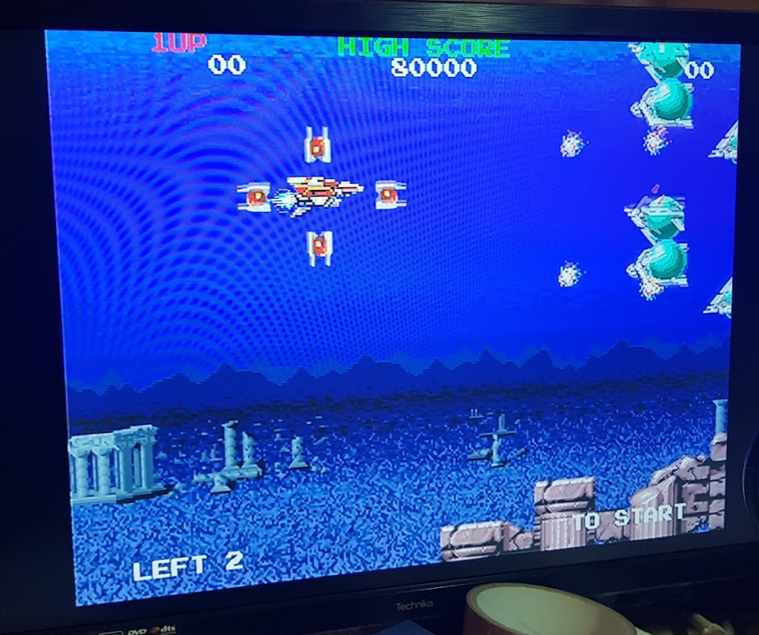

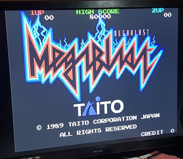

Fired the board up and ............
Yeh !! The lines have gone , Sorry i had no original to show you (Must try harder next time !)

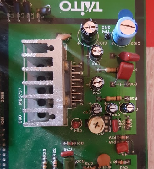

So next was the horrible scratchy audio , With most of these its caps and as I needed to remove the filter caps someone had tried to replaced I decided to the Audio caps at the same time. As said above these are hard and take a lot of heat to remove so you have to be mega careful, And even being mega careful it can go wrong. Luckily it did not for me and even though it took a while i replaced them :-
So thats the main audio section and this is the rest :-
After booting I was happy to hear all sound were good again !!!

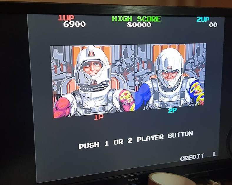

So basically thats its the game all runs and plays realy nice now. Only think left was to clean all the flux away (Hate it when its not done !) and have a play.
Few more of the game itself :
I must say this a realy good game but hard ??? Not sure what others think.
