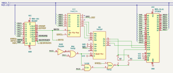

I noticed that the pin 1 of the 62256 ram on top board is not connected like it is in the schematics.

sub and audio CPUs are not running because the SRST is always low, because the BNKSW dosen't do anything either....
Also there is no actvity on the LS174 because the pin 9 dosen't change at all.... I did replace the PAL with no change at all.
Changing the HC245 at A2 gave an solid SUB CPU ERROR. Great progress! Pigybacking all other Fuitsu 245 brought the game back to life. 🥳
Gues I'll just swap all the fujitsu chips...
Problem solved.
