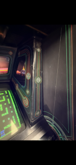

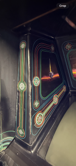

Just adding a couple more pics - I got a new marquee from Olly at arcade art shop which looks great. But still in two minds if I should replace the CPO and the art around the bezel - I like the originality but wondered if the new art would just make it really pop.
I will be looking to sell this aswell at some point (currently debating space available and which cabinets to keep or sell) so from a price/collector perspective what would be best, leave as-is or new art!
The new art from Phoenix would be something like £200-250 including shipping from the US.
