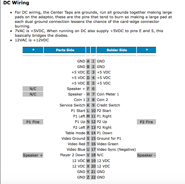

I used Mikes arcade DC wiring pinout to connect a switching power supply to an original Pac-Man (https://www.mikesarcade.com/cgi-bin/spies.cgi?action=url&type=pinout&page=Pac.html):
I assume that hooking an original board up this way is fine for long periods?
