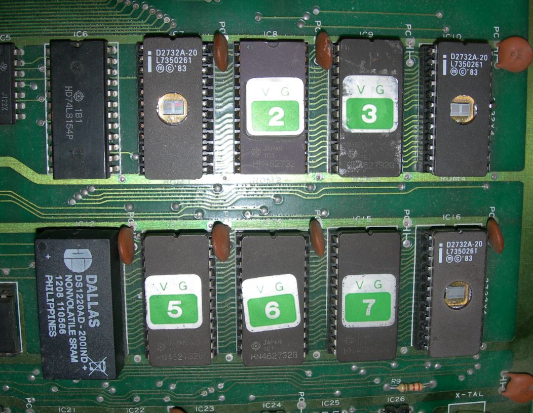

The high score save was actually easiest. The game uses a 1Kx8 4118 (socketed!) for programme memory which needs to be swapped out for a Dallas DS1220 module, then I just needed to bypass the code that clears the high score memory on startup. Add some code that does clear the high score memory when you hold down certain controls on power-up and that was it done.
The enhanced free play mod (maintains the attract demo whilst in free play mode) was more tricky. There is an unused DIP switch that I've used to set freeplay mode on and off. Vanguard relies on an NMI being generated when a coin is entered, so the programme doesn't have to keep checking for coins in software. As my code preloads the game with the right number of credits depending on P1 or P2 start buttons being pressed, I had to write a number of checks for the buttons being pressed during the demo mode. I then changed the code that writes the number of coins inserted onto the screen, and have it shown only in non-freeplay mode.
Finally when in freeplay mode, I didn't want coins being registered, so had to intercept the NMI routine to not accept coins unless in normal (paid) mode.
Happy to say I got all this working today, programmed and tested it in Mame, and extensively tested it on real hardware, I think all the bugs are out.
The code needs just 3 of the game ROMs changing, and a Dallas NVRAM module to save the high scores.

Modifications to the board
