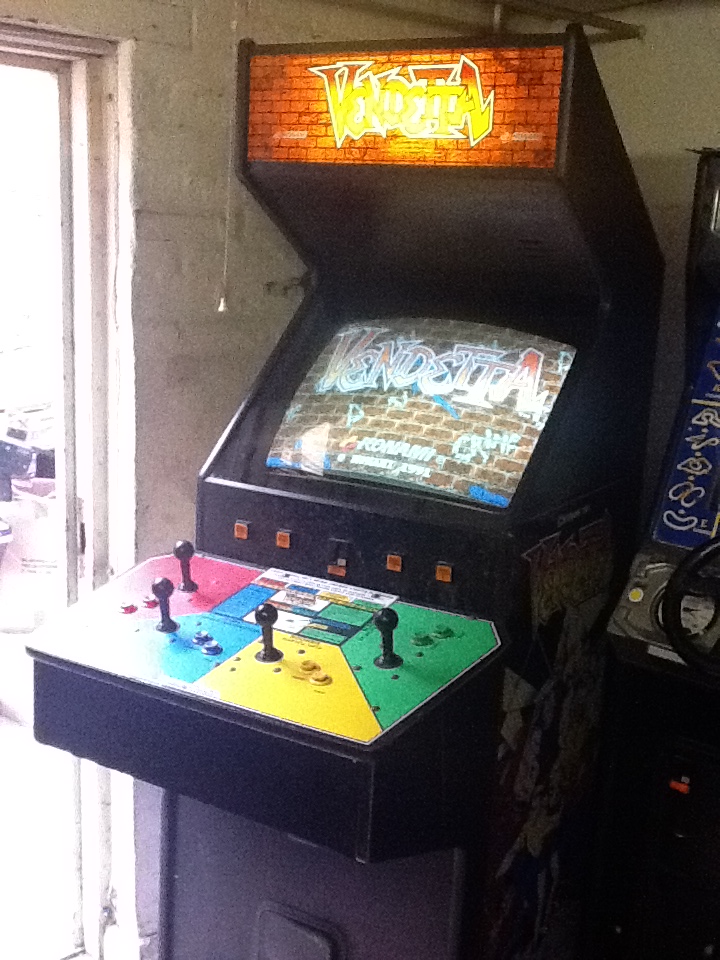

Well, I'm quite pleased with myself today, I know its hardly like restoring a faulty star wars cockpit but we all have to start somewhere, today I managed to remove the faulty monitor from my Vendetta cab & replace it with the working one I bought in the Vendetta donor cab I bought from here a few weeks ago.
To start with I was unsure if the monitor comes out from the back or front I'm so new to all this but went for the front so removed the joystick, removed the start buttons/coin slot section, removed the glass & I realised I'd made the right choice, removed the 4 bolts at the corners of the monitor & it was ready to take out, this was the only part that made me sweat as I was unsure exactly how heavy it was going to be, thankfully I was expecting worse & that was it the faulty screen was out.
Installed the new screen, plugged everything in & crossed my fingers, the music came on followed by the picture, it was a bit blury so I twiddled the knobs & I'm sorted out, a working Vendetta cab again
I was on a roll so even swapped the light tube in the marquee.
