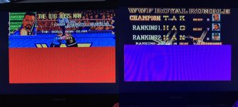

Fast forward a year and now I've got this little HD Video Converter unit which takes in SCART and outputs HDMI which I can use it on my test bench with a LCD because it has the benefit of cleaning up bad sync signals really quite well ! So I've dug out a few boards recently which have ropey sync to work on ... including this one ...
Thing is, even this setup had trouble with the sync ..... it was close ... but just not stable enough ...
You can't really see it very well on the above pics but the screen was not holding Horizontally, constantly twitching or dragging left to right. Quite annoying but at least I could see the game was running fine and displaying correctly in the top half of the screen. Not much good the lower half though ....

OK so onto the obvious display/graphics issue .. and a fairly straight forward one ... anytime the screen or a portion of the screen is blanketed like above I always firstly suspect the highest priority graphics layer, which is usually the character/text layer ... so I went about identifying this part of the circuitry by bridging address pins of various RAM's on the board looking for changes on screen. Didn't take long to find what I was looking for ... 2x 6116 RAM's in the lower corner of the board by the Jamma edge ... messing with one of them gave corruption to the text layer in the good upper half of the screen, messing with the other one did absolutely nothing ... grabbed a new RAM and piggy backed this now prime suspect ...

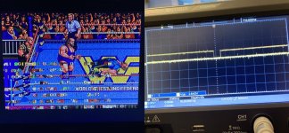

You can see the improvement below left ... (pic below right is what the signals on this RAMs data pins looked like before piggy backing, obviously not great!!)
So got rid of that and put in a new RAM chip ...
Which fixed the graphics
