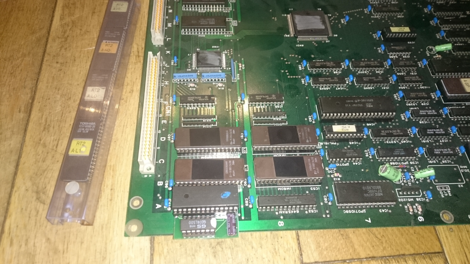

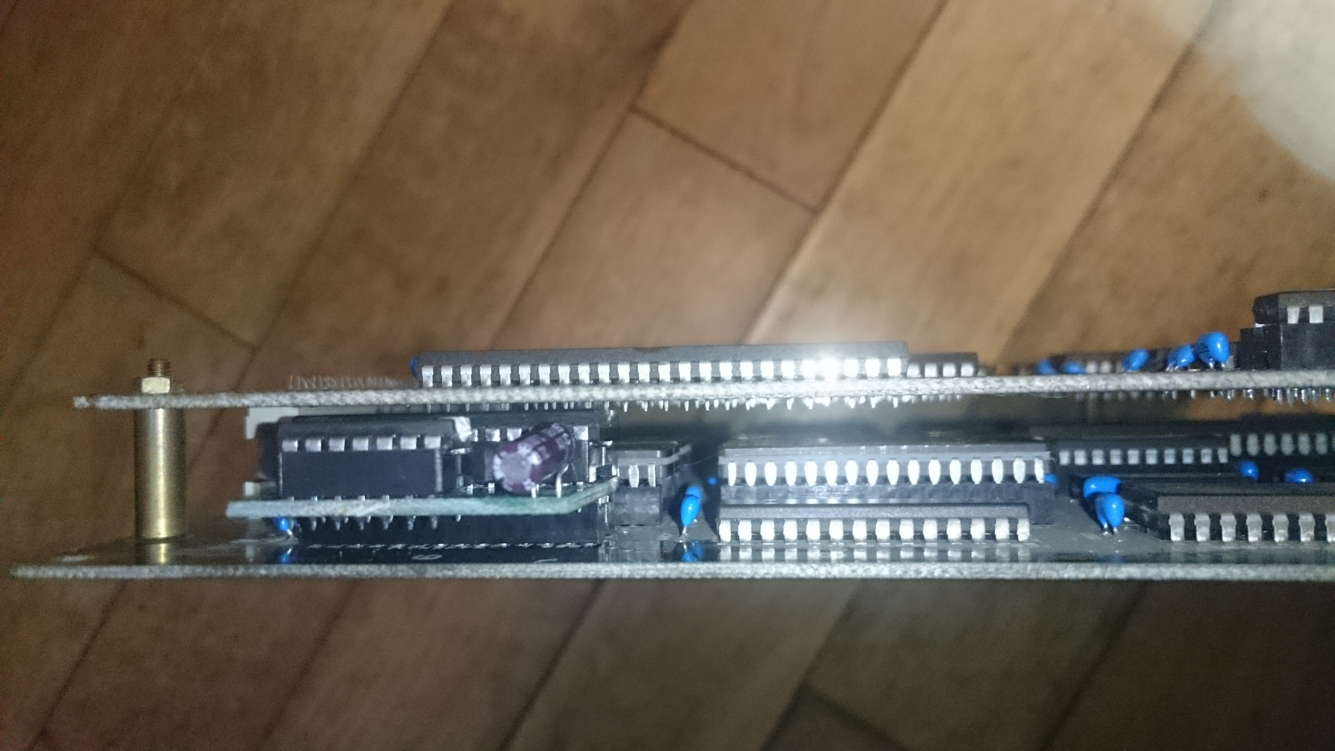

Well Recently done both my Hammerin' Harry [M84] and R-Type II [M84]
Had to put shorter legs on the ram adaptor board to make it fit, bit snug but works perfectly...
Pics of my R-Type II [M84]
