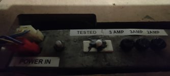

Perhaps it is easiest to post some pictures of what you have ?
I have my Hantarex PSU serviced and they all run well. This is other power supply type which I have in another xenon.
