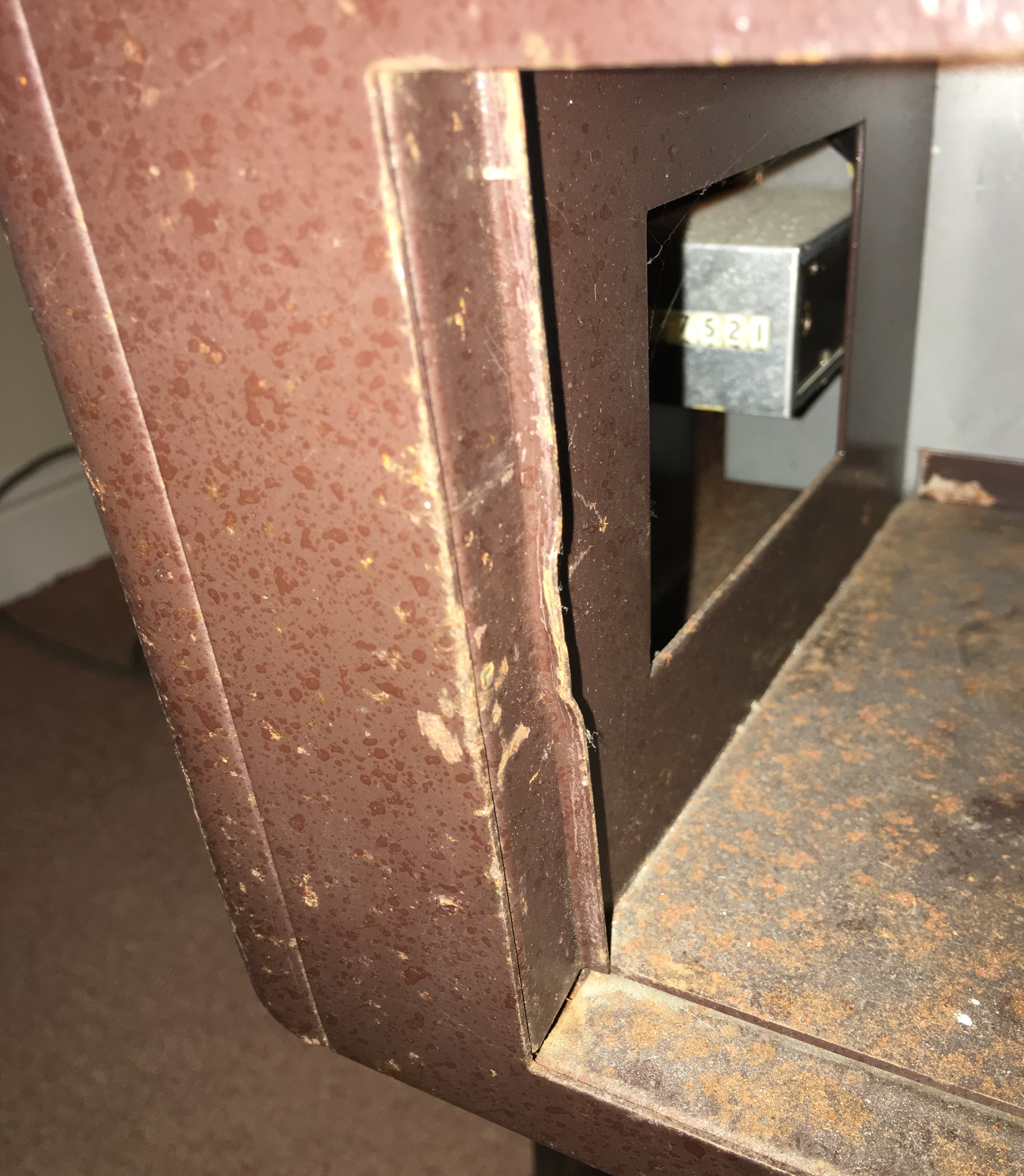

Original coin mech is here along with a relatively tidy coin door (just a small bend on the lip):
Tucked away in that last picture we can see the credit count, which on this one is showing a nice low number:

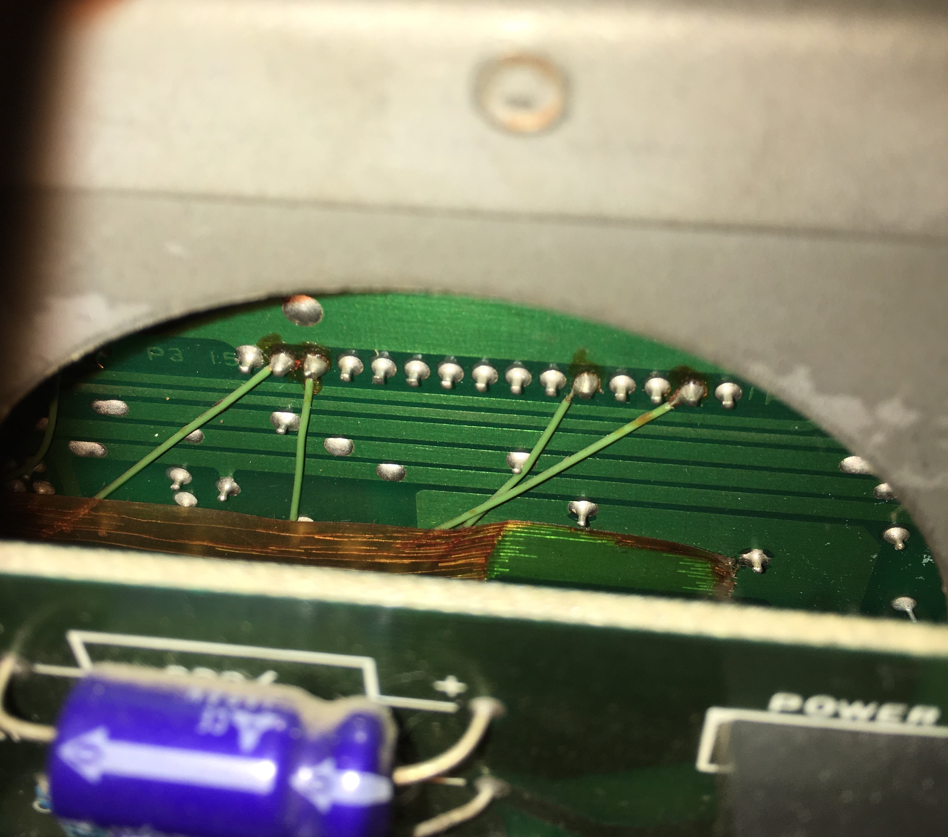

It looks the same as Olly's inside so I won't bother posting those pics (until I've got a comparison shot atleast), but it'll put a couple up of the boards. It appears that one of the boards gained some damaged traces at some point:
Which explains the additional green wire fixes on the reverse of this board:
There's also what appears to be an empty IC socket???

So it turns out the empty IC slot is supposed to be empty and the cut traces I'm assuming were done at factory as the two other examples of the PCB I can find pictures of online have the same traces cut (pin 2 and pin 5 of the connector)...

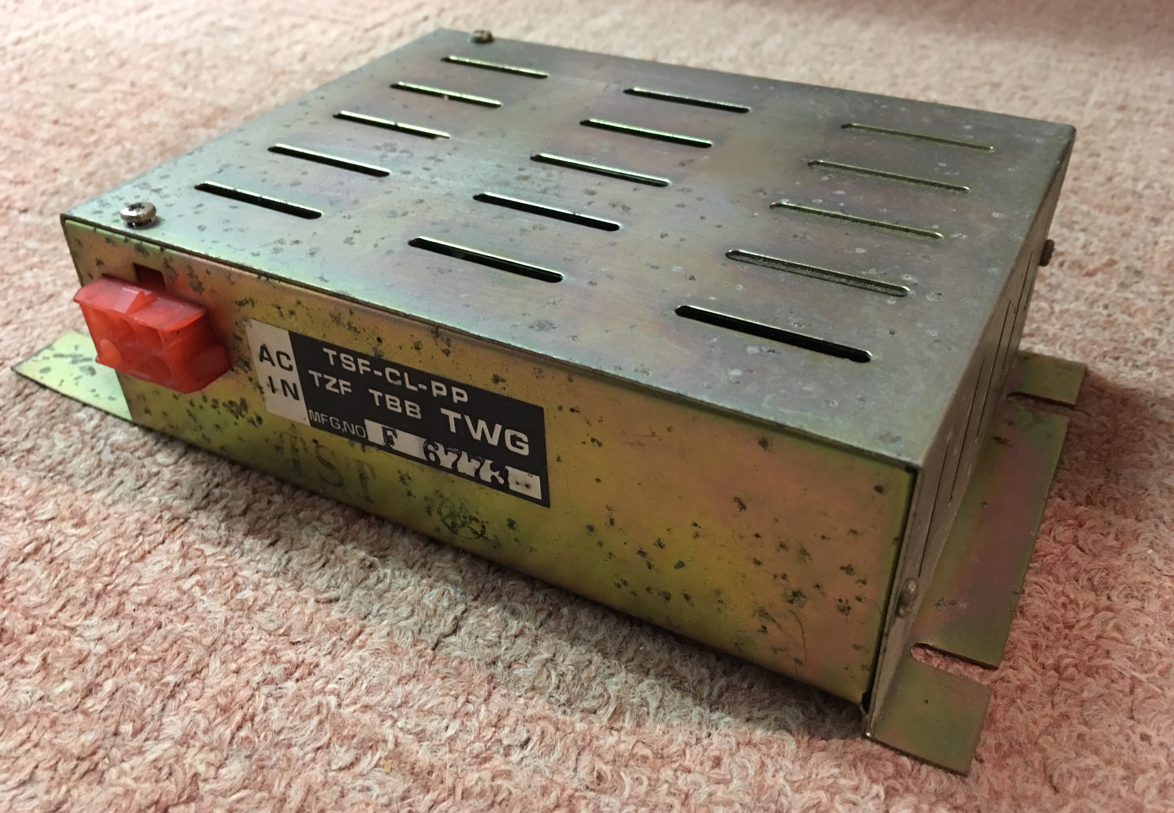

So I'm the interest of science, I pulled the PSU. Firstly to see get the model number in a desperate hunt for a working replacement, but secondly to see if there were any obvious signs of wonkyness!
So out she came and a quick photo to start my search:
So it appears this PSU was fitted to a number of cabs (going by the three letter Nintendo codes), but oddly the code for HeliFire is missing (TUB), which from a scout on the KLOV forums, there are some that include TUB.
So whilst she was out I thought I'd open her up:
All looks normal (apart from the brown spots which I assuming are from moisture), apart from this one chip:
Looks a little "fizzed". No damage to the chip that I can see, but some interesting gunk!

My firebird had this psu fitted but it was modded back in the day and had a heatsink with a tin can voltage regulator (5v I assume) and a large cap, it seemed to work well in all the years I have had the machine but I have recently mocked up a switcher to resemble the old psu. only drawback is no 24v for the meters! If you fancy copying that mod I'm happy to supply pictures?

Ronnies solution looks pretty tidy but if it were me I'd rebuild the original power supply, there's not exactly much on it.
I'm going to wire up a new switcher that I've got to start the process of elimination for finding the faults. Got my fingers crossed the new PSU will allow me to boot the game, but I know that's wishful thinking
I bought the switcher from ArcadeShop with the DK conversion board, and reckon I can fab up the two connectors I need for the standard loom.
Ideally I would like to keep the original, but going on Olly's experience I'm not holding out much hope. Are the 5v regs the small white oblongs Olly? If so, I think one of mine has gone (popped/ leaked)JonathanClayton2017-05-16 20:41:48

Yeah there is some weird parts on the board! looks to have been problematic back in the day judging by the mod and the sticker of the company that repaired it.
The other firebird I had also had it's psu swapped for another linear supply with a transformer on, stuck out like a sore thumb!
I may at some point rebuild this one but try and contain everything inside the case, maybe use a smaller tab 5v regulator if it would supply the amps, that's the question?

Should be fairly east to connect a switcher for testing, the 5v 12v and ground have 3 and 4 wires each! so you could solder wires solder side just for testing. I would guess your psu 5v will be bad
2,206CR
It's the black blocks, there's quite a lot going on inside there.
