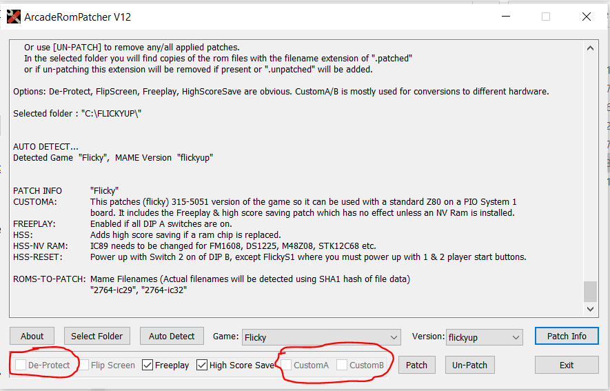

My only issue left is trying to get this to boot on an Up n' Down board set. It seems your patcher even when selecting patch info. there is not a DE-Protect or CUSTOM A / CUSTOM B selection only the HSS & Freeplay patches.
Below is the Up n' Down boardset details and how I went about trying to get the boardset to run Flicky, it may be a case of incorrect roms locations or you just haven't created a patch for this particular boardset. I have seen a picture on Ebay where the REV.A boadset is running Flicky on an Up n' Down boardset but with a SEGA protection CPU in place but was trying to get Flicky to run on my REV. B boardset with a standard Z80 CPU.
Could you let me know where I am going wrong please?.
Issue: UP n' Down Board set to Flicky - Black Screen error after patching roms Ic29 & 32 using roms from FLICKUP set.

Rom Patcher 'Patch info' details:-
The De-Protect option is used when I am bypassing some protection system, not when it requires whole roms to be decrypted. The FlickyUp rom set requires a 315-5051 CPU whereas the UpNDown one uses a 315-5098, I have not made a decrypted version of this set, hence no Custom A option. To do a decryption takes some time as you have to work through all 32K of rom space making sure you have found all the code areas. Sega make this difficult a lot of the time because they put small tables in the middle of the code quite often which have to be decrypted differently to code areas. If I find the time I will let you know.
