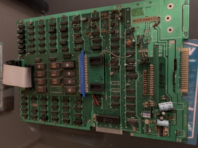

Hi, those Artic boards were designed to run multiple games by just swapping the PCB with EPROMs on it so
if there is no labelling on that card the only way to know for sure
would be to read the EPROMs and check their contents against known
ROMsets.
There's a ROM ident website you could try if you're able to read them:
http://romident.coinopflorida.com/
I
believe most of the Artic games were copies of popular 80's titles with
minimal changes to make them run on the Artic hardware.
Hope that helps, regards John.
