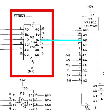

The part of circuitry that deals with the text generation on screen is shown below, eight data lines are fed into the 74LS174 at N3 from shared RAM N2 & P2 (Not shown), they are clocked through the the 74LS174 by the *HRDWR signal. When the signal is low, the CPU is stopped by the STPCLK signal, and data will pass through into the Prom at R3 where its parallel output is converted to serial and is then summed with the other video signals.

Clearly some sort of text was still visible, The outputs of the 74LS174 should all be held high in test mode essentially making all the bits of the Prom output no data. Checking with my logic probe output pins 5, 7, 10 & 12 were held high but pin 2 was pulsing away with data and triggering the Prom to display garbage data on the screen all the time. I temporarily linked pin 2, to the 5v supply (forcing the signal high) and sure enough the garbled text went away
I removed the device, fitted a socket and replaced with a new 74LS174. Upon re-powering the game everything was working as it should be. Replaced IC shown below.
