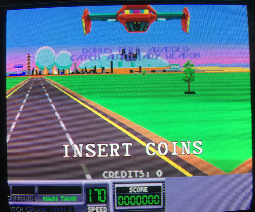

And of course I instantly had the same tile/sprite corruption. Anyway after a bit of Prom manipulation I have got PP, MM, IJ & RR to work perfectly but at the moment RB won't.
I have tried a multitude of things to no avail. None of the car sprites appear but the trees do and the biggest issue is that the left/right scrolling of the road fails completely. It's like the raster interrupt that sets the tile X scroll position is failing completely as the whole road and bottom info panel scroll left/right as one block.
At the moment I am stumped again and cannot see any reason why this is the case, of course it could be that it will never work on the older carts. But having gone over and over and over the schematics the small differences with the GFX roms / Proms / Slags should not really pose any problems...........

I have the road scrolling issue on my Cockpit Boardset too !! - Luke says this is a power supply issue, think one of the chips in the sound section generates an interrupt on each line and it needs a funky voltage perhaps ?
Also no car sprites either , so pretty much the same fault.

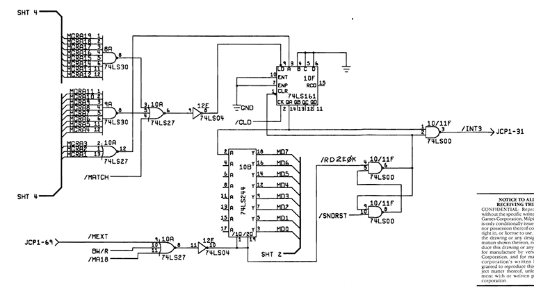

Thanks Colin, that made go back to the schematics again and look afresh at the carts. That's when I spotted a few extra TTL that I hadn't really paid much attention to before.
It seems that TTL, LSI & LSI Cart 2's do not have anything connected to the /INT3 (J1-31) pin on the edge connector which is how I think they are generating the mid screen scrolling.
Here is the schematic section from a Cart 3 PDF.
I imagine you scroll issue is to do with one of these TTL's being faulty.
Of course it means that the RB on the multi will never work on anything less than a Cart 3! So I can stop looking
