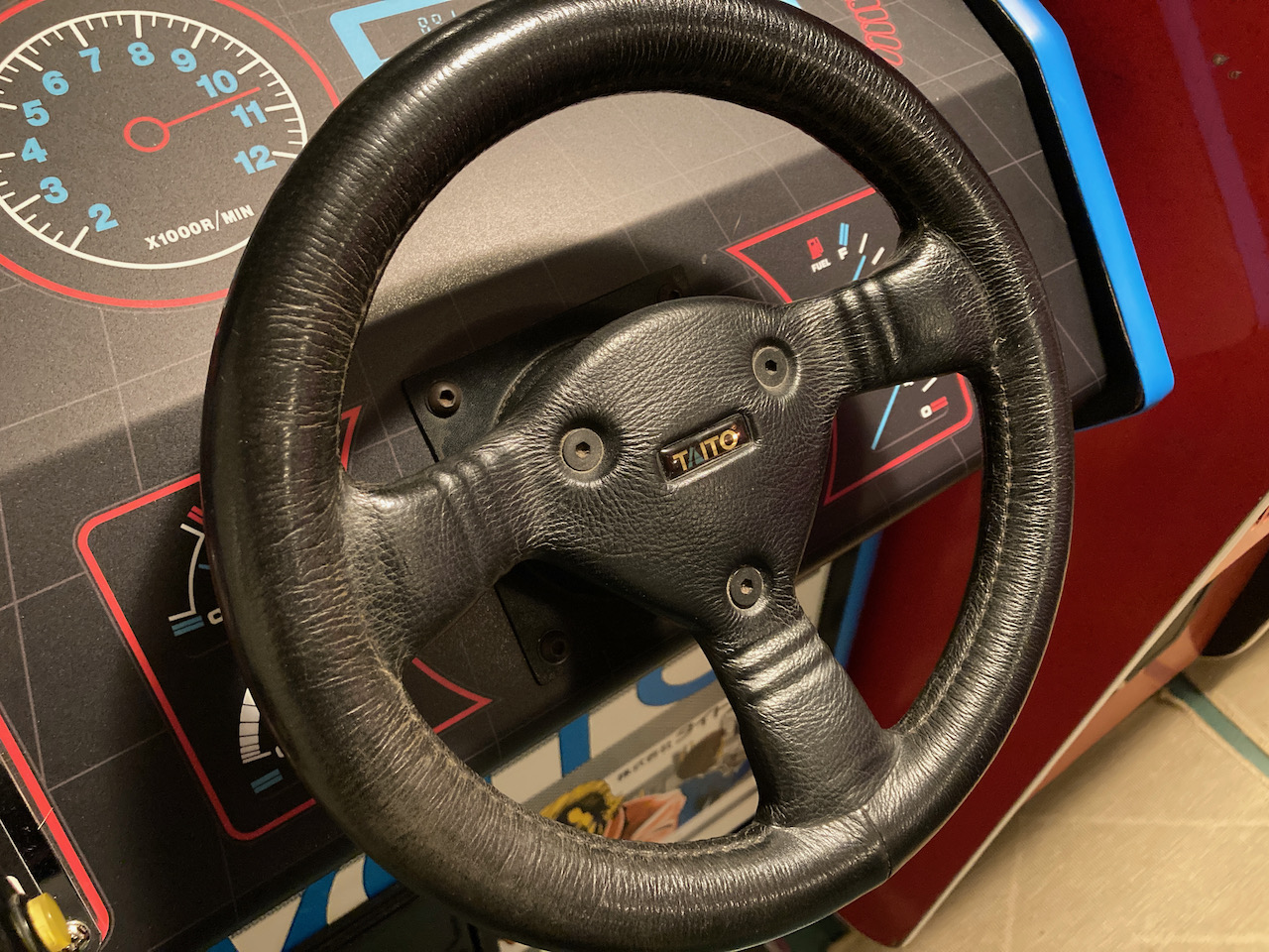

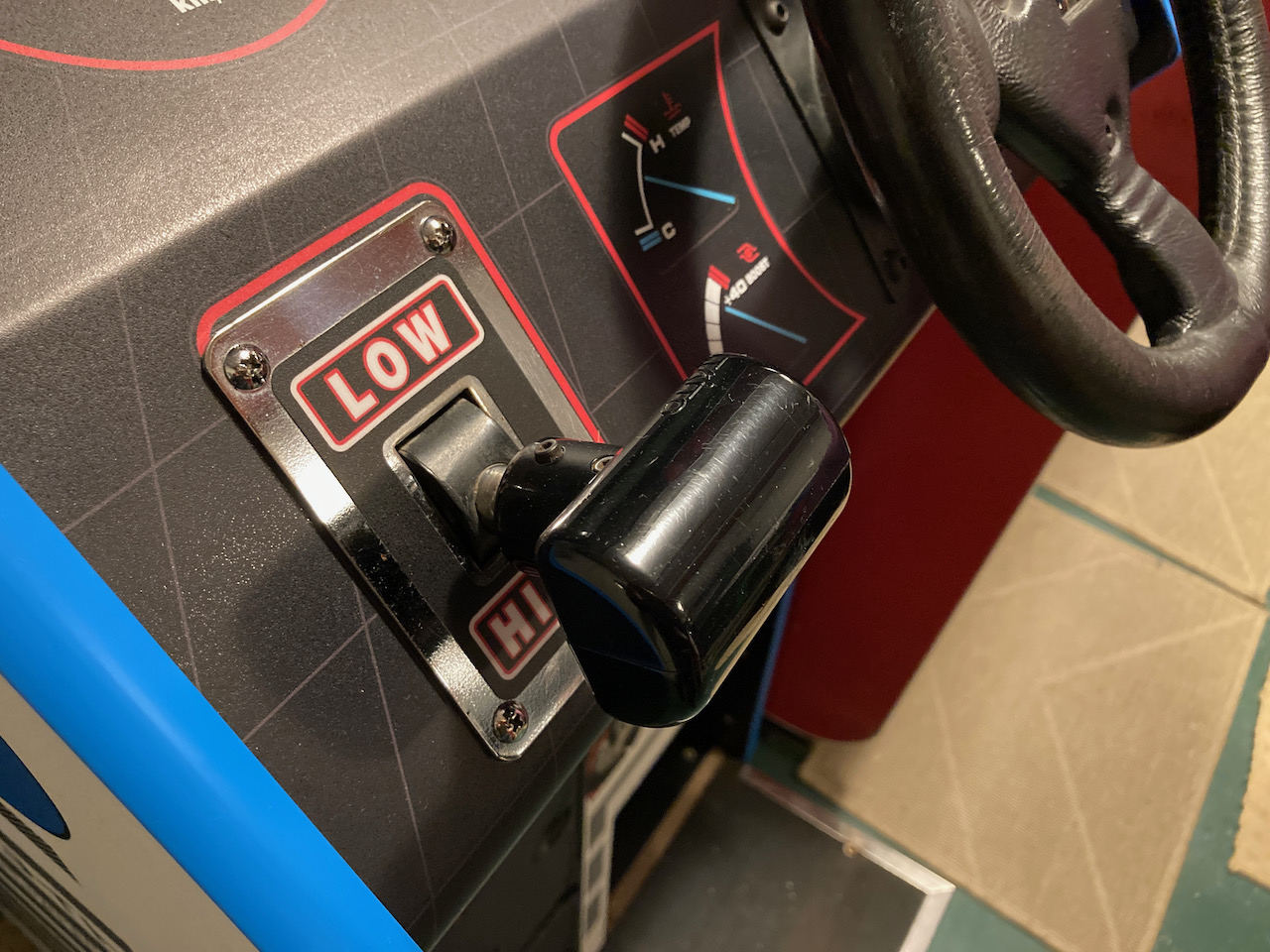

The restoration is finished!! :)
I finished the foot pedal restore and also cleaned up both coin doors. New locks and a working coin mech. Currently set to 2 plays 50p! like the old days. Even gave the coin mech a clean up , ha ha
A few pics of it all complete
