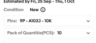

All the A103j x6
Have some corroded legs ?
Underside
Checked all legs have continuity to adjacent legs with traces running to them .
Assuming corrosion on legs
New resistors on way any way .
