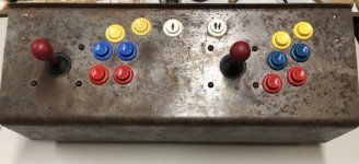

Oh wow, so they did choose to sell these control panels with just hammerite point and even talked it up as a selling paint over a control panel overlay.

The plastic monitor surround shouts Atari System 1 or 2 with me
looking at the flyer of cab I think its probably the standard flat thick card same as Centi and Goliath so it can be turned around with screen
