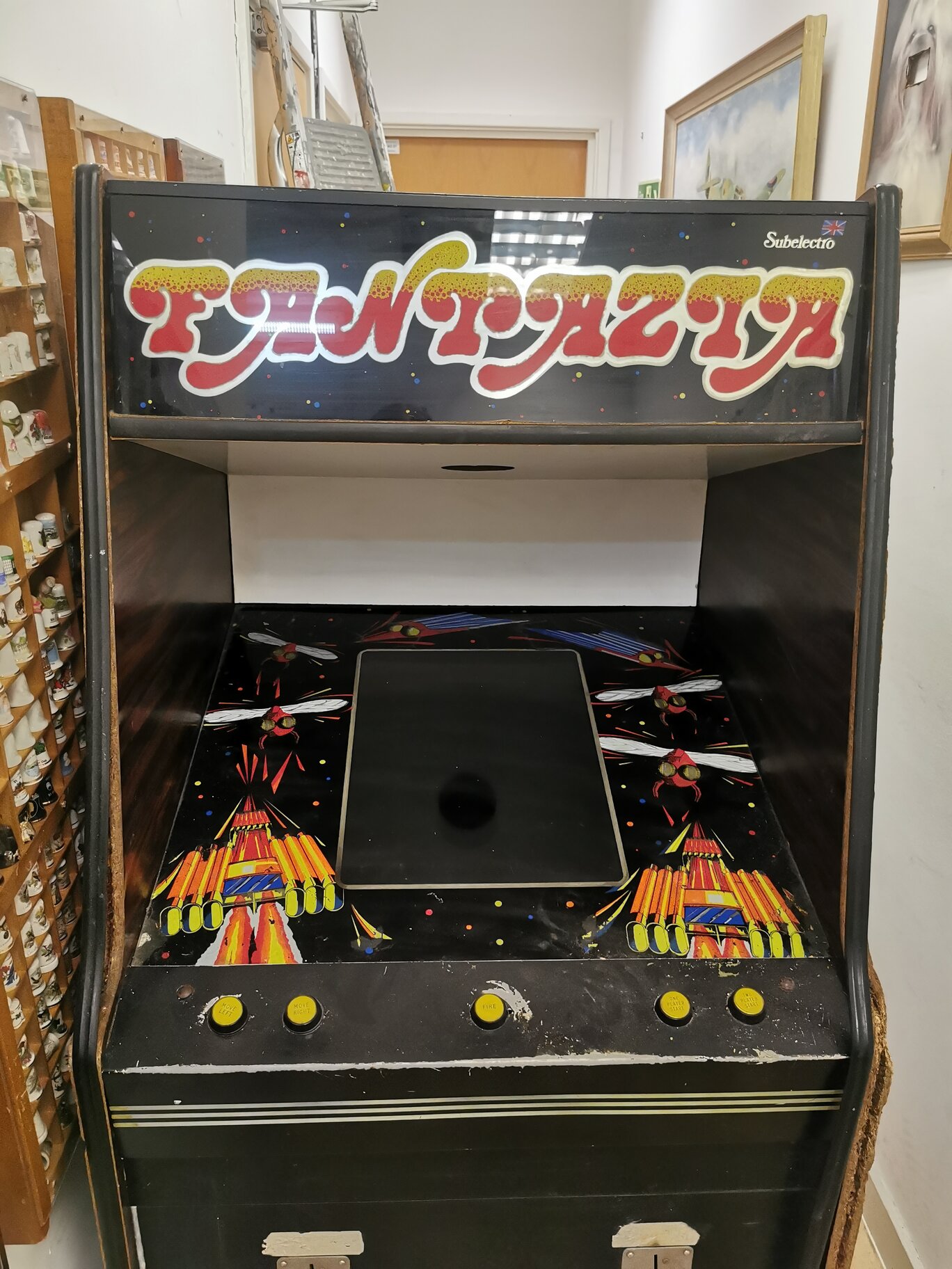

Here are a few pics of our newly acquired machine.

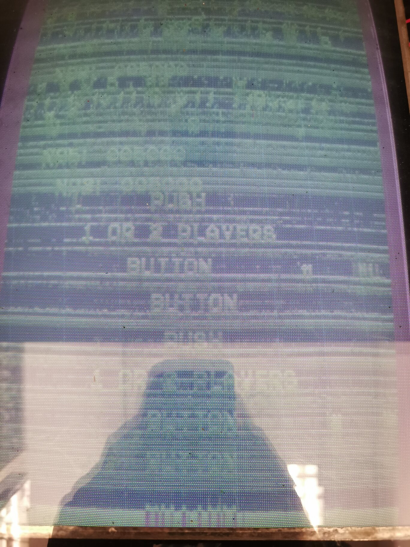

And the worst bit

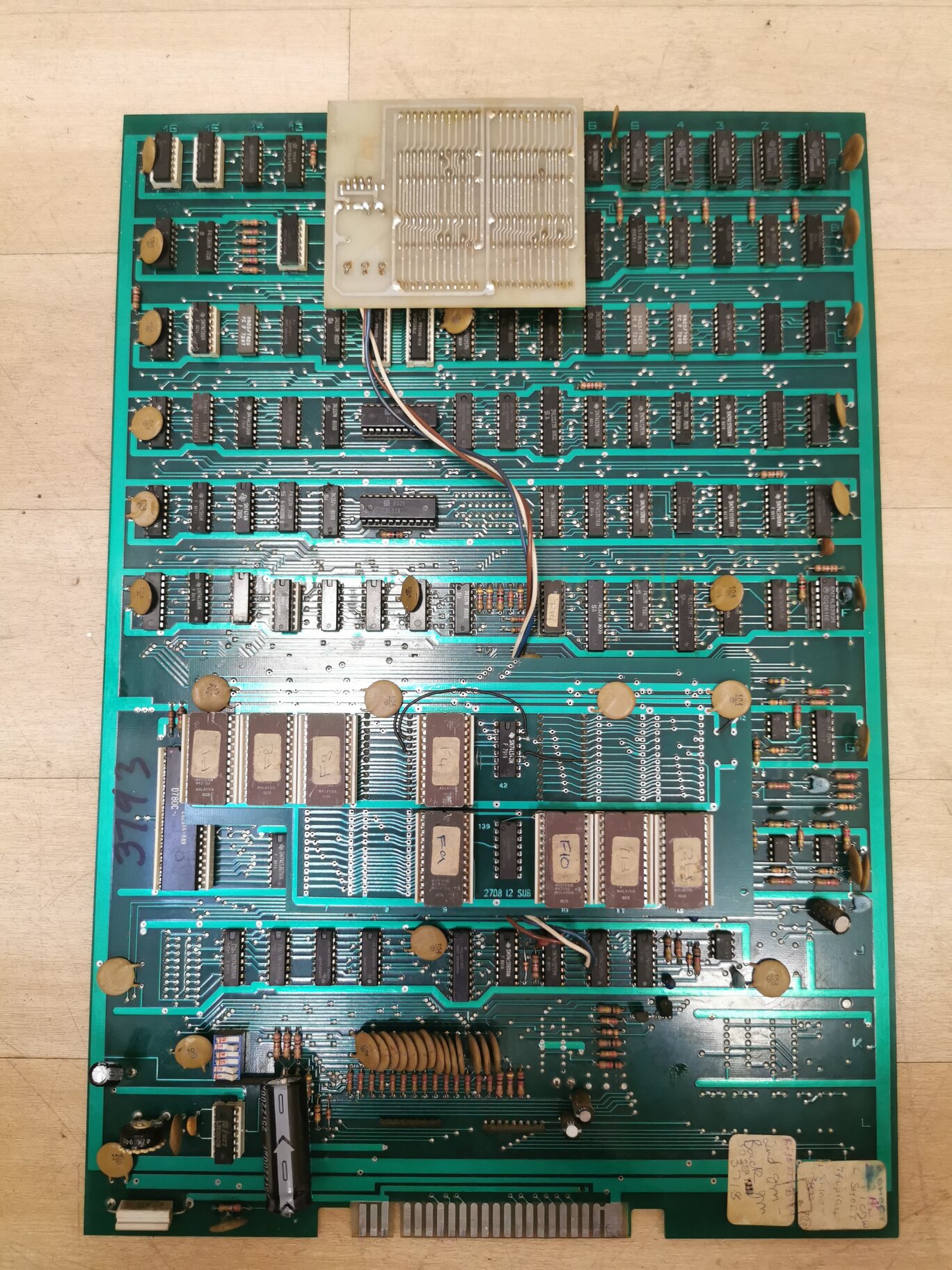

clearly there is an issue with the board, Since getting this machine we have done a few things to the board to attempt to remedy it but neither myself or Lookmumnocomputer (Sam) have any arcade specific knowledge.
Things done so far
A lot of the ram chips on the top right of the board were missing legs due to corrosion and have been replaced and resocketed as required.
All electrolytic caps have been changed on the mainboard and in the power supply board.
with zero knowledge we are now a bit stumped as to what our next step should be, we do have access to oscilloscopes and bits of test equipment.
Any pointers or advice would be greatly received
A huge thankyou in advance.

If you look in the FixLog section you see I am playing with the same board at the moment... I would be very interested to know what you have in your colour PROM.
I cannot really tell from your image if that is being displayed or is just burn-in.

That is being displayed, the crt doesnt appear to have any burn in at all.

Well to get that far a lot of things must be doing a lot of things right!
With two things... a PCB and a Monitor... there are between zero and two things that can be broken... Do you have a way of testing the monitor or PCB in isolation?
The fact that it is rendering the welcome screen and it is synced really shows that the majority of the text side at least is working. The fact it is monochrome perhaps suggests a problem in the final stages which is really only the colour PROM and the monitor itself.

Yes i will check the voltages at the main connector for the board. its not monochrome either just very green there is other colour there but alas my phone camera didn't do it justice.
