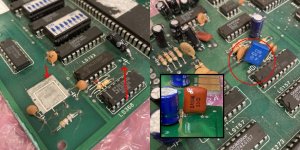

A few visible issues caught the eye on first look ... with most probably due to poor storage/handling at some point in it's life ... components half hanging off etc

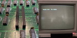

Board won't boot without a crystal providing a cpu clock, or solid reset signal (pic above left) so first up was a bit of research ... This board should have 2 crystals - a 24Mhz crystal and a 10Mhz crystal. The missing one near the cpu is the 24 Mhz so that's an easy enough fix - in went one of those. The blown cap is 10uf, again easy swap. but the missing capacitor I have no idea what it's value is so I tried looking for images of this board online and I found a few that are similar layout but none the exact same. Some versions have the PLCC on the main board and no daughter board, and I can see there should be 2 capacitors in that area but none are high enough resolutions to read any cap values. On most the pictures I looked at the 'missing' cap was a bit larger in physical size than the other. The 10uF cap is connected to the nearby LS132 (and GND) and the missing cap connects to the nearby diode (and GND). Haven't come across this dual reset capacitor setup before so asked chatGPT about it and it thinks Cap 1 (missing bigger one) creates the main power-on reset delay, whereas Cap 2 (10µF) filters / stabilises shaped reset. So recommends a 22uF or 47uF for the missing cap. Went with a 47uF ...
The resonator and film capacitor that are both hanging on by one leg (above right pic) are in the sound section so are not on the priority list. Usually tackle sound last.

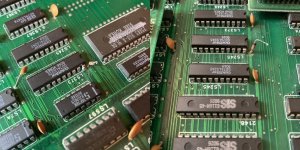

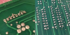

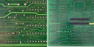

Next up ... crushed pins everywhere on the solder side of the main pcb, (see below) plenty touching where they shouldn't. Despite this, hardly any scratches to the pcb (a few superficial ones) and cant see any obvious trace damage at first glance. Spent a while straightening them all up and making sure nothing was shorting ...

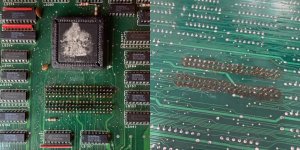

Last thing before first switch on .... corrosion and/or excess dried flux on the daughter board connector pins, this is present on both the daughter board and the main pcb socket soldering. PLCC socket on the daughter board has seen better days too .. scratched and scuffed, some pins in it look to be tarnished or corroded ... see below ...
Did my best to clean this up and most of it did clean off in the end. Not 100% convinced this still wouldn't be an issue but it looked a lot better and worth a go to see what we'd get on screen when powered up.. Which was absolutely NOTHING :) not a sausage, screen didn't even blink ..

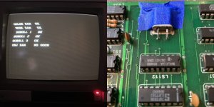

A quick probe of the CPU did show signs of life, replacement 24Mhz crystal must be all good as have a nice (50%) 12Mhz clock on pin 15 of the 68000 CPU (y) Halt and Reset both HIGH (y) Voltage on the pcb was also fine (y)
But with literally no acknowledgement by the monitor that the board was powered up I suspected a video timing issue, so checked the 10Mhz crystal and got some pretty crazy readings on the scope. Frequency jumping all over the place (see below) anywhere between around 50 - 70 MHz ... weird. OK but if the other crystal was knocked off completely and there are signs other components have been knocked loose or off all together, then it's not out of the realm of possibility this crystal has taken a few knocks and it's damaged inside.
With no new ones to hand, had to take a 10Mhz crystal off another board to put on this, and typically it's 40 year old legs just fell off during the transplant 😣 I've eventually managed to solder it back together but had to tape it down, it's connections are so fragile, it's broke off a few times. Just need it to last until some new ones arrive!
But this didn't change much, other than now the monitor was reacting to power on, a flicker, a slight change in the tone of black on the screen. Scope now measuring 30MHz on the crystal. Still weird. But it felt like there was now sync. Thinking now I'm not sure why I didn't just check the sync signal at the Jamma edge at that time (probably because my setup doesn't allow for easy board flip overs to access the underside of boards), but I didn't. Just went back to checking the CPU....

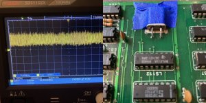

No activity on the address and data bus, but DTACK did show 3 little pulses of signal on power up, then would get stuck high. So seems like the CPU starts, attempts its first few bus cycles… then gets stuck waiting forever. Same was happening on A1 and ROM /enable pins. Bad ROM or data bus behaviour?
What I realised at this point was during this probing I didn't have the daughter board connected (I'd needed access under it, tracing signals /CE's, etc) ... and when I plugged it back in I was getting more activity, some data lines had signal, A1 and A2 had signal ... still nothing on screen. But then I did see a flicker, and it was when moving the daughterboard, it's not got the most secure connection. the pins are in the middle of the board so it can rock around on all corners if you press it. Yes small flickers on the screen when pressing the daughter board.
So I take it off and look at the PLCC, remove it from the socket, there is some tarnishing on some pins and some look a bit pushed back into the rear of the socket. So give it a clean best I can and ease out all the pins to try and get better contact to the chip.
This is after I've cleaned it up best I can, you can't see it as well on these pictures but the tarnishing/light corrosion on the pins on the middle of the row is still present. Chip back in the socket and daughter board back plugged in and lo and behold the screen comes to life .....
Rocking the daughter board around gently, varied the garbage on the screen but here in this position I can see the word 'COLOR' and I now have a good idea what's going on... The boot is stalling on the startup RAM tests. I saw this on the other board I fixed. That's why bus activity is minimal and the CPU is hanging shortly after power on.
I just couldn't see it because this daughter board is dodgy as hell with it's connection to the main board and its PLCC socket.
I'm guessing the boot is hanging on WORK RAM test (which comes straight after COLOR RAM) but I don't know for sure, and there's no point chasing a WORK RAM fault if it's not that.

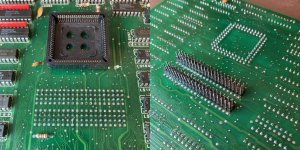

So I decide the best course of action is to sort out the connection issues on the daughter board in the hope that if that's all sorted I will be able to see exactly which RAM is failing the boot test. And when I looked properly at the connection pins and socket I realise I need to just remove it all and replace with new. Which means de-soldering 80 pins from the daughter board a 84 pin PLCC socket. A couple of the pins were loose already. You could tell someone else had identified the connection issues at some point before me and had tried to reflow the PLCC socket, as well as the connection pins, but a few of the via's had already gone so some traces weren't connected. They probably spent a load of time on it and when it didn't work got pissed off so didn't bother cleaning off the 20 gallons of flux they used which is why it looked so bad.
I took everything off, took ages 🙂 repaired broken via's and tiny traces. put in a new PLCC socket and a new connection socket on the main board (Another 80 pins!). Looked quite tidy in the end though ... And thankfully (or I may have not cleaned my flux off either!!) it worked, cleaned up the picture on screen 👊

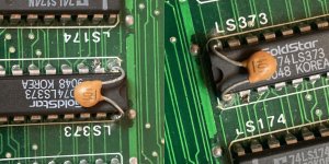

Now surely that's not right, those IC's won't work at those voltages will they ? I know it's a bootleg but these can't be original surely, I've looked online at pictures of other boards similar to this (can't find any pics of this particular board) and none of them have these 'alterations'
Someone trying to fix this issue before? noticed bus contention and undervolted some IC's to weaken them ?? Will never know I guess. I've removed them for now anyway and reinstated their 5v legs direct to the rail ....
So the 3x LS373 (1 with the resistor hack and 2 with the cap hack) that feed the LS157 before the palette ram get replaced cause I just don't trust them and I've snipped a pin or two on them chasing the dodgy signals ...

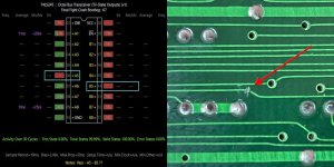

Went over these (and others) with scope and slice looking for anything untoward but nothing major stood out. Did get a few IC's not obviously on the data bus net fail the slice tests (LS368, LS74, LS283) which I swapped out but wasn't surprised when it didn't help with the boot problem.
Had another good check around for damaged traces and on the daughter board came across this missing piece of track !!! .. and looks like it was never there !!! wondering if this was done purposefully I reinstated the loss of continuity with a long bodge wire, thinking I can either tidy it up later with a smaller repair, or remove it easily if necessary, won't know till later if this was necessary I guess until I get this running !!
Again I didn't expect this to be involved in the data bus and was unsurprised when it made no difference to it not booting ....

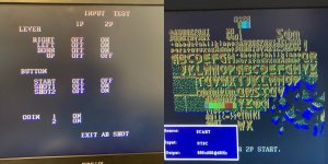

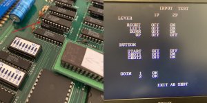

First power up with the hacked program roms booted to the screen above left ... INPUT TEST screen ... not sure why at this point ... some of the inputs were flickering super fast between ON and OFF (you can see on the pic above the ones that look like they say ONF) ... while some where just stuck ON ...
First thought was ok I've got a bad LS245 handling those inputs and maybe this is the dodgy IC corrupting the data bus ... grabbed a 245 and piggybacked each of the LS245's handling those inputs .... the one pictured below left had the effect of stopping the flickering ... just stuck those inputs either ON or OFF ...
Because this one had that effect when piggybacked, I removed it and socketed in a new one, booted with optimism and got some interesting results ...

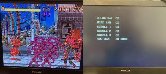

At first the RAM tests went a bit further but the game would keep rebooting .... at various points ....
One time it actually went into the game 😳 And i got quite excited !!
But was brought quickly back down when it crashed and rebooted after showing the guy sitting in his office 😖 and settled on crashing and rebooting over and over to the same point ....
I thought I must be getting close at this point and the fact the game now continued to crash and reboot over and over at (seemingly) the same point - during work ram test - made me jump in thinking it's probably one of the two 62256 work/program ram at fault .... it wasn't ... removed and socketed both, no change 😩
I think what I also noticed here was that depending on how long the board had been running I got slightly different results on boot ... when cold I'd often get the INPUT TEST screen (below left), as it got a little warmer I might get this screen (below right) ...
But as soon as it warmed up a bit more it would settle into the constant reboot pattern during RAM tests ... tbc

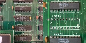

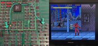

So at this point I've convinced myself the problem lies in the main program area, I've socketed the program/work RAM and put known working chips in, I've socketed in new hacked program ROM's ... then I went over the area with the multimeter looked for and marking all the IC's connected to the data bus .. Now that I'm running the hacked roms the CPU is no longer stuck in the small infinite loop and there is more activity on the bus logic ... Slicing the marked IC's I found this LS373 was failing on one pin ...

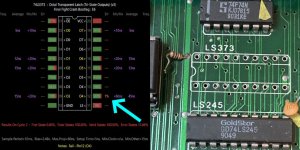

As you can see this is one of the IC's that had had it's +5v supply hacked through a resistor which I'd removed a while ago, that output signal connects to the LS245 below it and directly to a CPU data pin, so it came out and got replaced and despite the new chip performing better (much smaller fail on that pin) it made no noticeable difference. The marked LS74 (not on data bus) above that IC also failed Slice quite badly so got changed out but again (unsurprisingly) no marked difference made ... To rule it out I also swapped out the LS245 which was receiving the O4 signal from the 373 ... but again this had no effect ..
I was now just chasing any IC's on the bus in that area and removed another LS245 buffering the palette RAM data .... another IC that had had it's +5v supply hacked this time through a diode ...
But this didn't help either .... still with a narrow focus on this area but running out of suspects I started to wonder if the CPU was bad ... so I removed it and put in a known worker ... but again no difference ... and at this point I'd replaced and ruled out a number of IC's in the area ....

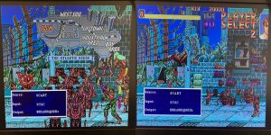

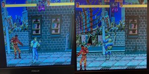

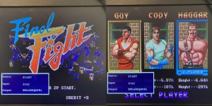

But it wasn't until I replaced that 2nd LS245 near the jamma edge (buffering inputs) that I got a breakthrough .... the game booted further than it ever had before ...
Credits were adding on their own and player 2 character moving on its own ... still got bus corruption !!
For the first time I could see the probable cause of the issue ... sprites !!! I hadn't really looked in this area at all up to now but headed straight over to the sprite ram with a couple of 6116 to piggyback and got some improvement when on one of them ....
But then I could not get the game to run again, back to stuck on the INPUT TEST screen , or crashing ... but if I piggy backed and wiggled that same ram chip on the input test screen I could change the inputs that were stuck to ON ... to OFF ... this convinced me to swap out that ram chip which I did but it didn't make too much difference ... it wasn't until I swapped out its LS245 data buffer that finally .... the board now boots and runs the game .... every single time !!!
OK still got some sprite issues but finally some major progress made ... no more bus corruption ... 👊

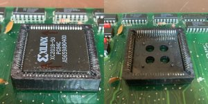

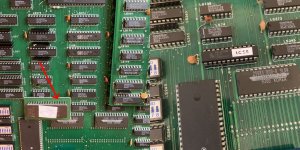

Here's a close up ....
I believe it's a XC1736A. A configuration PROM for the nearby Xilinx XC2018-50 FPGA chip on the daughter board..
These are one time programmable and you can still buy them, but I have no idea how to read this one I have, or then program a new one !!!!!
Maybe someone else does ????
