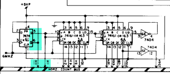

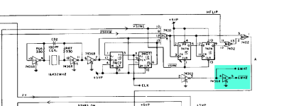

Once you are settled... trace the clock back... look at 1E pins 4 and 5... you should have 6MHz...
then follow this forward to the horizontal video...
You should have a clock at pin 5 of 6C
That should appear at...
the buffer at 8D
go in pin 14 and out 13... and into the CPU socket.
Trace that through and see how you go.

You needn't to proceed until you have the correct voltage at the supply pins of the ICs (especially cpu) and having a working clock signal at pin 6 of the cpu. If there's no clock signal, go back to the oscillator (1st schematic digram above) - watch pin 7 of the 74368. If there is no activity, there won't be activity on any point later in the clock chain. If the oscillator isn't working, suspect the 74368 and the quartz. Despite it is not very prone to fail, check C32 as well. If you have activity there, then go on checking 7407 / pin 3 and pin 6, the clock signals of the 7474 flip flops (pin 3 / pin 11) and the utputs of the flip flops (pn 5 / pin 9). So proceed until you get to pin 14 / 74367, if ok, check pin 13 also. If the activity stops at one point in the line, you've found the faulty IC.
