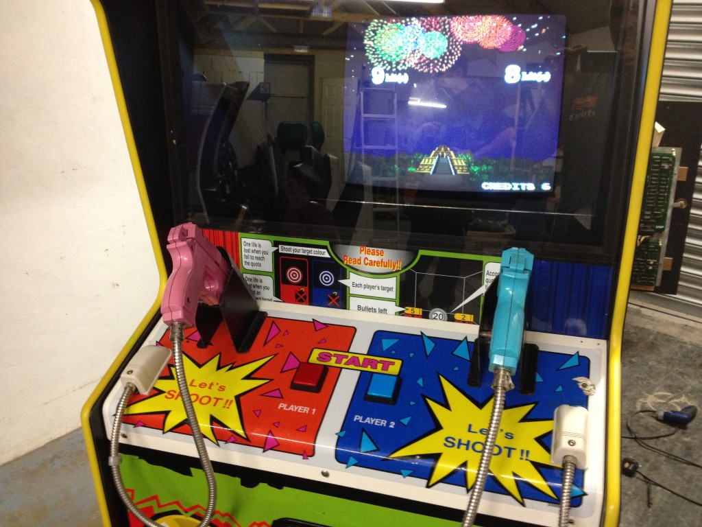

Got the inkling to fix point blank 2 today. Arrived as not working. Fixed a power routing issue and everything fired up - great! Added a few credits all working but alas no gun recoil :(. Checked everything all ok so took the guns apart and the solonoid powe cables were off. Put back together all working great!
Sometimes it is an 'easy fix' and worth taking the gamble.
Pics up soon.

Nice
My OP Wolf had no recoil and it was just a wire that was disconnected and wrapped round the loom. I think Op's sometimes disable the recoil
