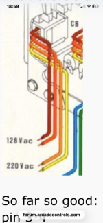

Ok got it 👍
Thin wires on this.

110v will be just about in spec for the chassis. The other one looks to be 100v output for stuff like Japanese chassis, that will be too low for the Hanty. The MTC900/E service manual says the lowest it will work on is 108v so you might just about get away with running it on that one. You don't need the 220v/240v degauss input connected to power up the chassis just for testing. I'd wire up the 110v one and check what you're getting from the output before connecting it to the chassis though.

Going by the type of connectors used on that iso, it's probably had a WG chassis connected. I'd say that the three pin plug with two wires is the power input, and the two pin plug is the output. I can't remember which way round they're connected though, as in what colour is used for live and what is used for neutral. It's using USA wiring colours, probably worth looking in a WG K7000 manual for example.
