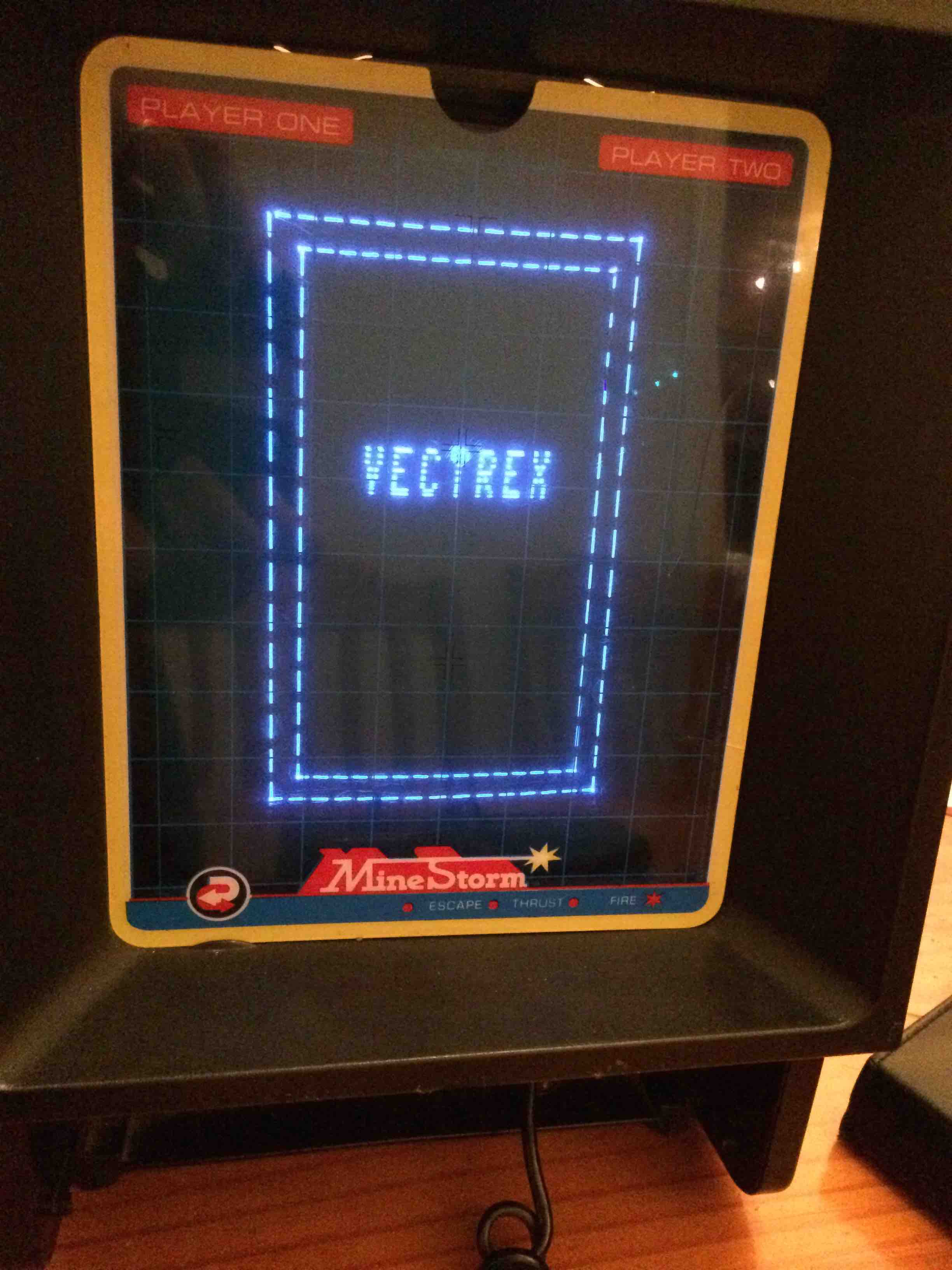

Nothing quite like having 2 bits of kit to do side by side debug. First off, I swapped the fuse...and voila!
That's what was up. I had a careful look around the components on both, but nothing looked bad.
So, after several months of sniffing around - I now have 2 working Vectrex!
I called them Buzz and NoBuzz (although I've rename it BuzzNot).
Buzz screen isn't the best, the board looks well loved over the years.
BuzzNot, screen is minty, innards look hardly used - but the fire button on the controller is a bit unresponsive (but is the model that doesn't like multicarts)

BuzzNot lives!!!
Only kids and cats should get excited by boxes, apparently...
Ready for action!
OK - it was only a freekin fuse, but who knew!
