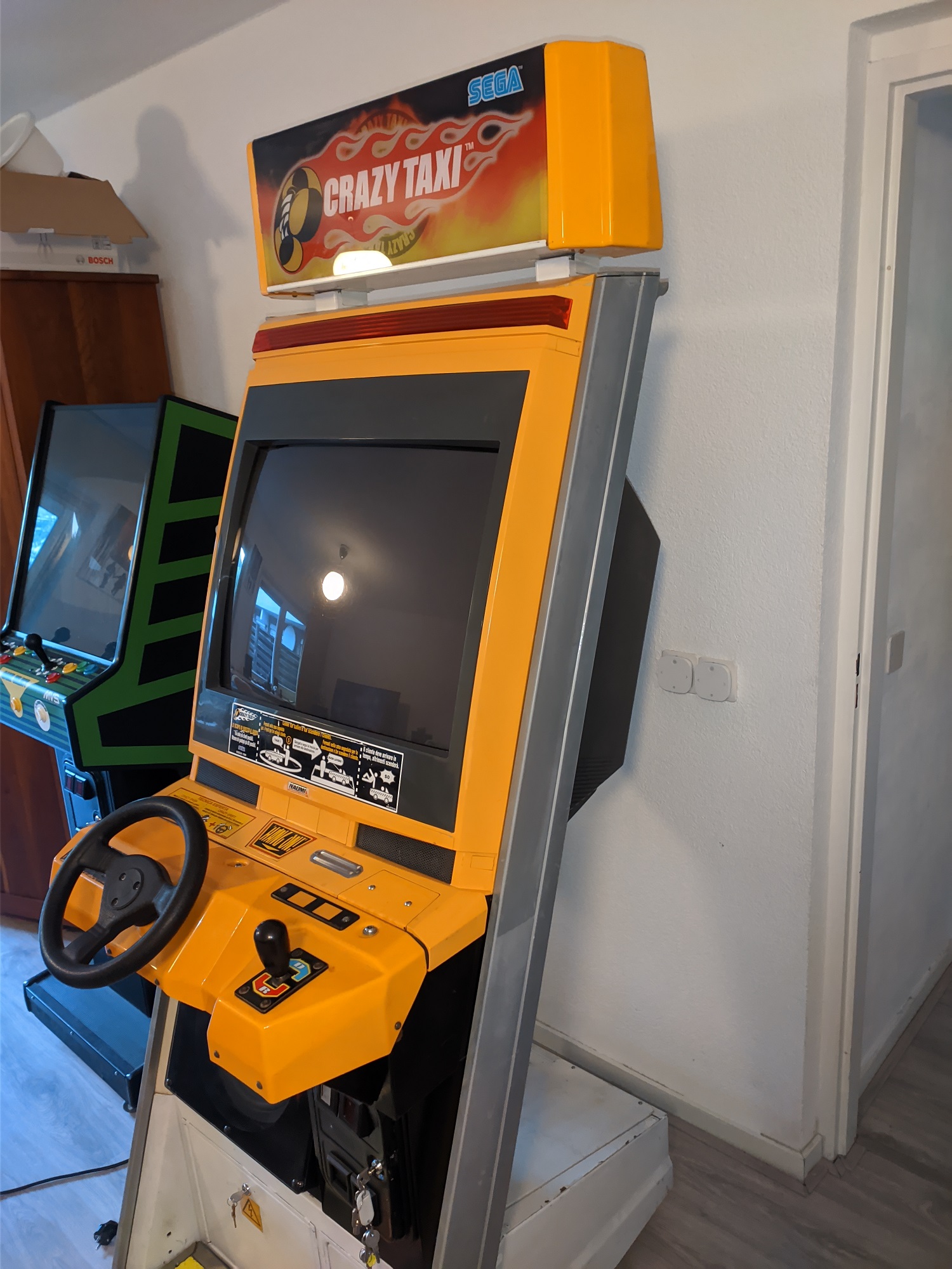

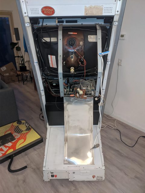

Finally I could afford it... One of my holy grails is finally my possession: an original Sega Crazy Tazi in a Naomi standup cabinet:

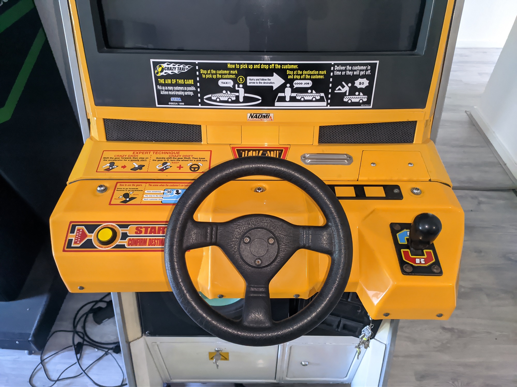

So why is it in the restorations page then? Well for starters, half the artwork is missing and the ones that are there are in Italian:

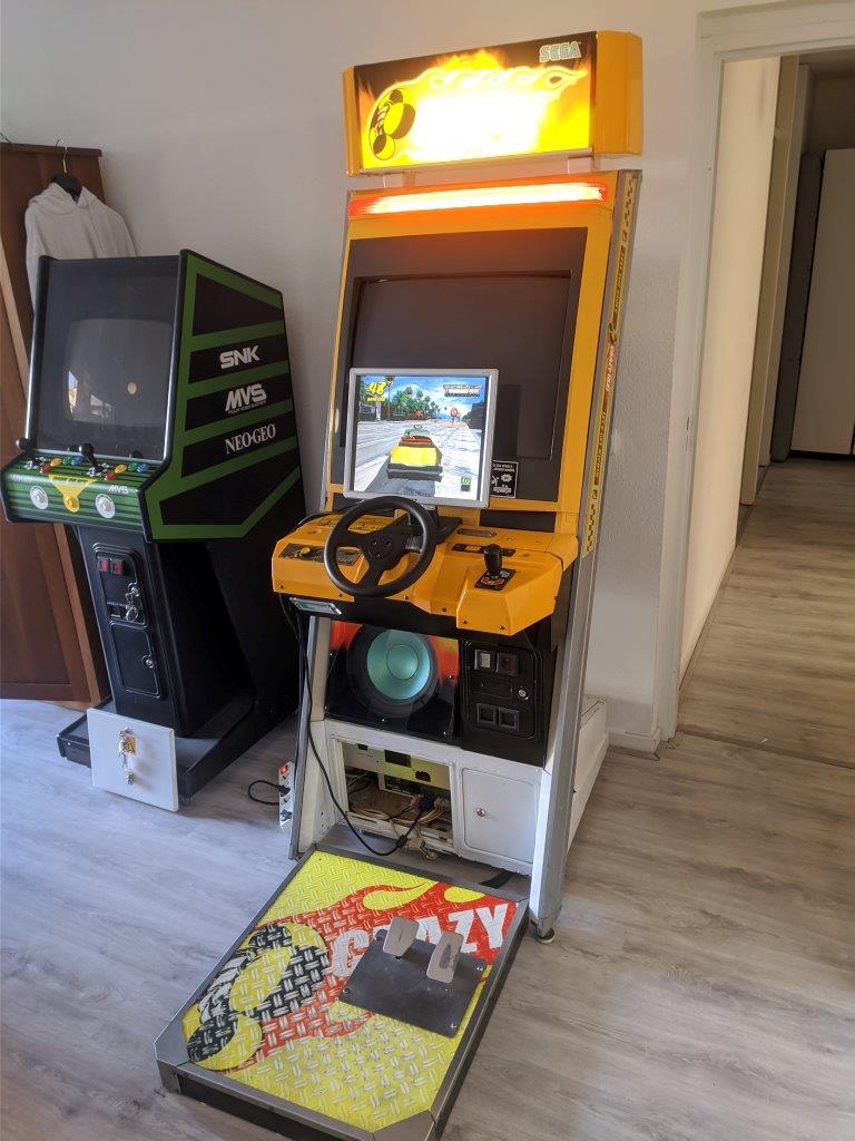

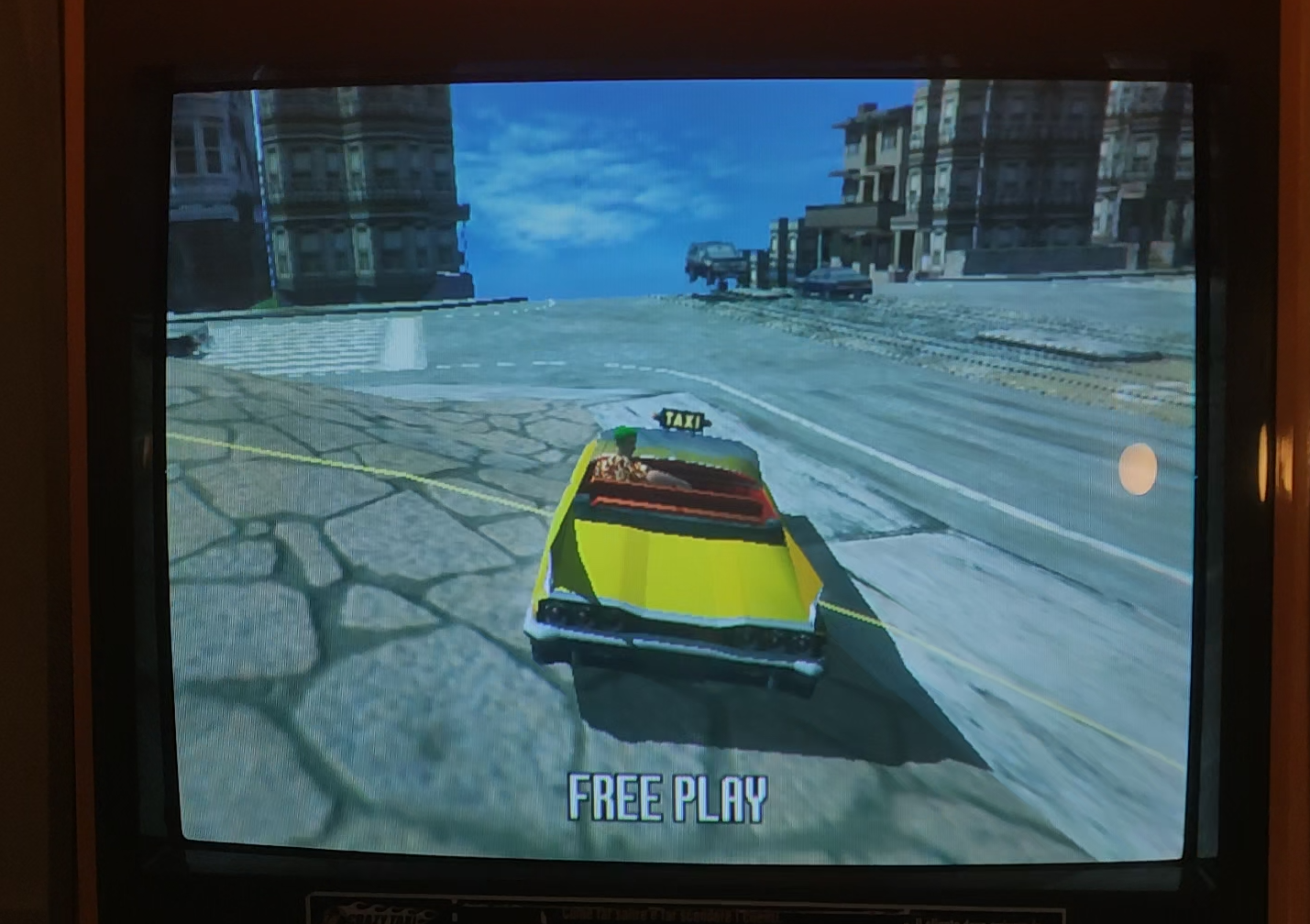

Also, I am playing it like this:
Because the monitor does this:
This is a classic example of a CRT with a bad yoke. I measured the vertical impedance to double check and it’s 12.7 Ohms, twice the value it should be. One of the parallel windings is open.

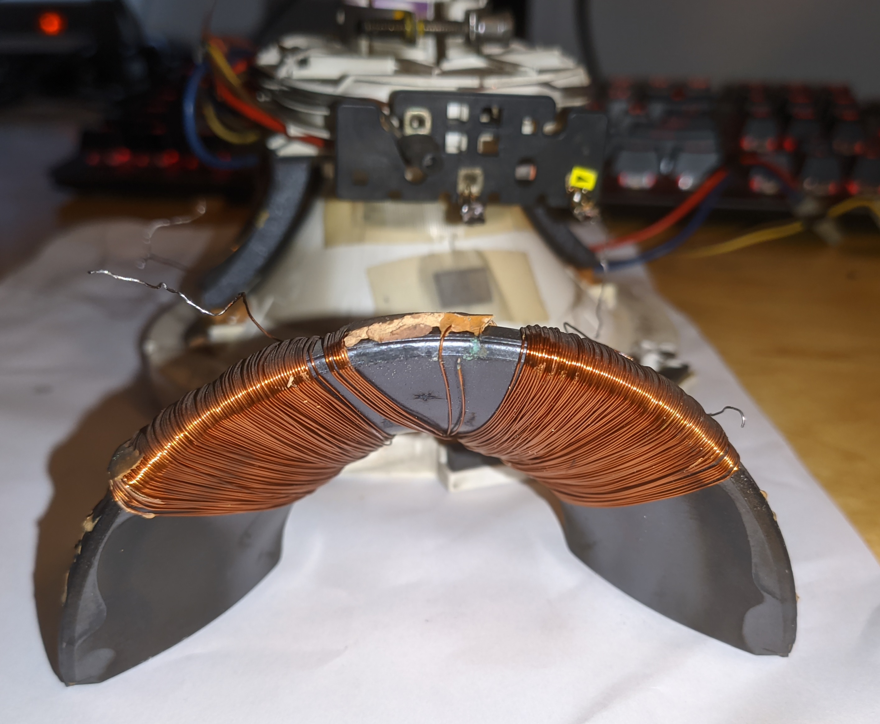

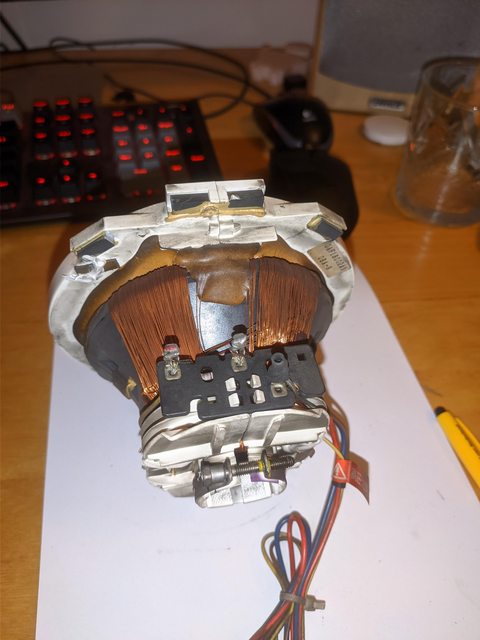

Yoke is off. Most stressful part was getting off the purity rings as they were completely glued to the neck from factory paint marker. Some sweat later and here we are:
So next up is disassembling the yoke and trying to see if I can find the issue. Let's see if I report back with great success or great failure

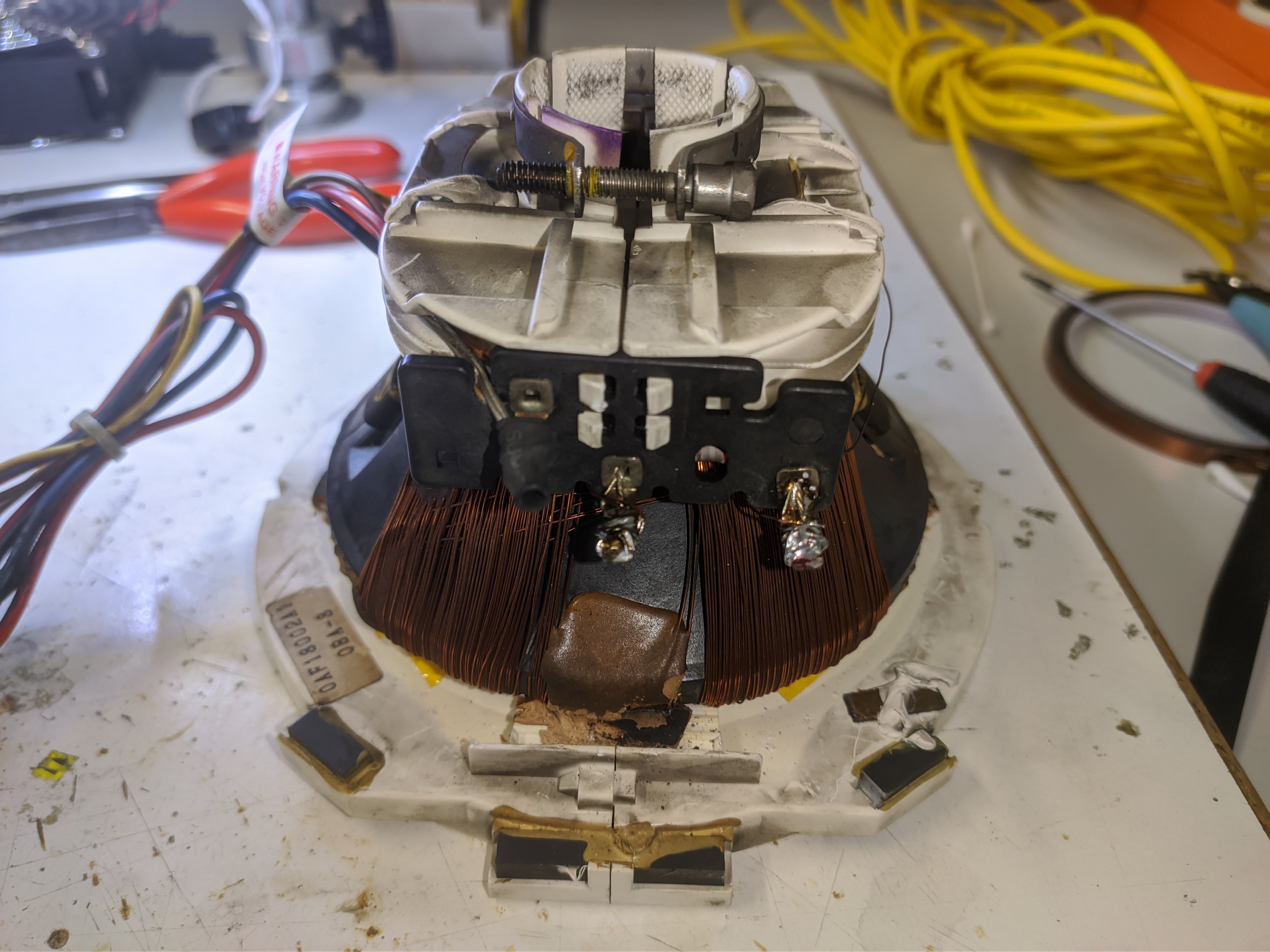

Reporting back with great success

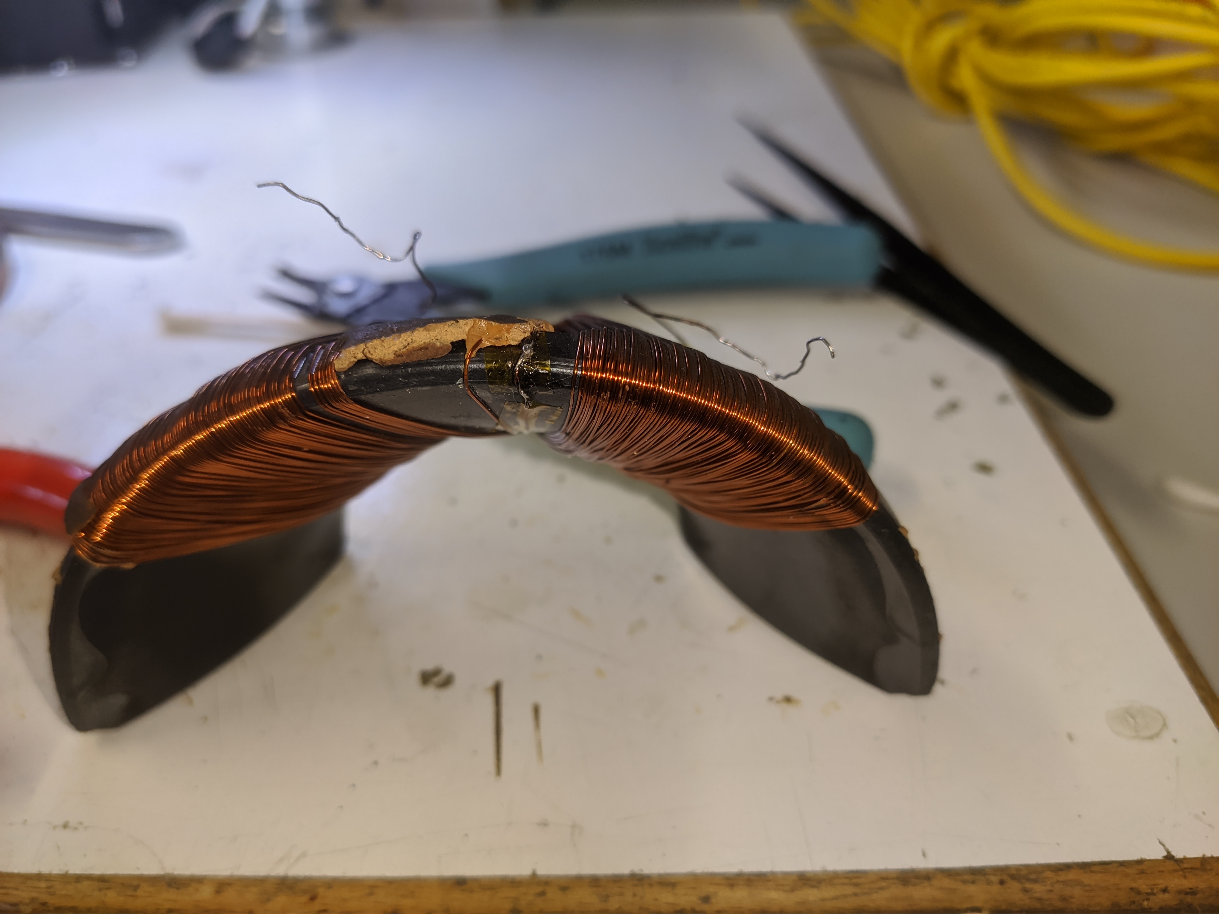

So I desoldered the yoke wires, pried off the glue and there was the broken wire hiding beneith:
Put a jumper wire:
Soldered the thing together again:
One heart attack turning it on after assembly later... NICE:
Next week my high temperature RTV silicone will come in and I'll reinforce my yoke patches. For now, I am very happy to play this game properly

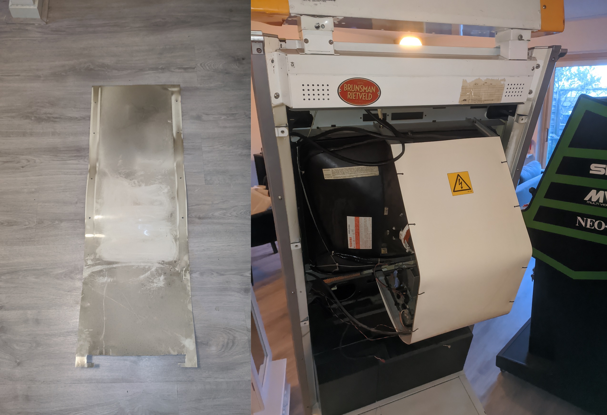

Not super picture worthy, nut about 25% of the screws on this naomi were either missing or just utterly mismatched.
Turns out you can buy stainless steel security torx nuts from Aliexpress pretty cheap. They are not an exact head size, nut no one but the utmost nerds will notice.

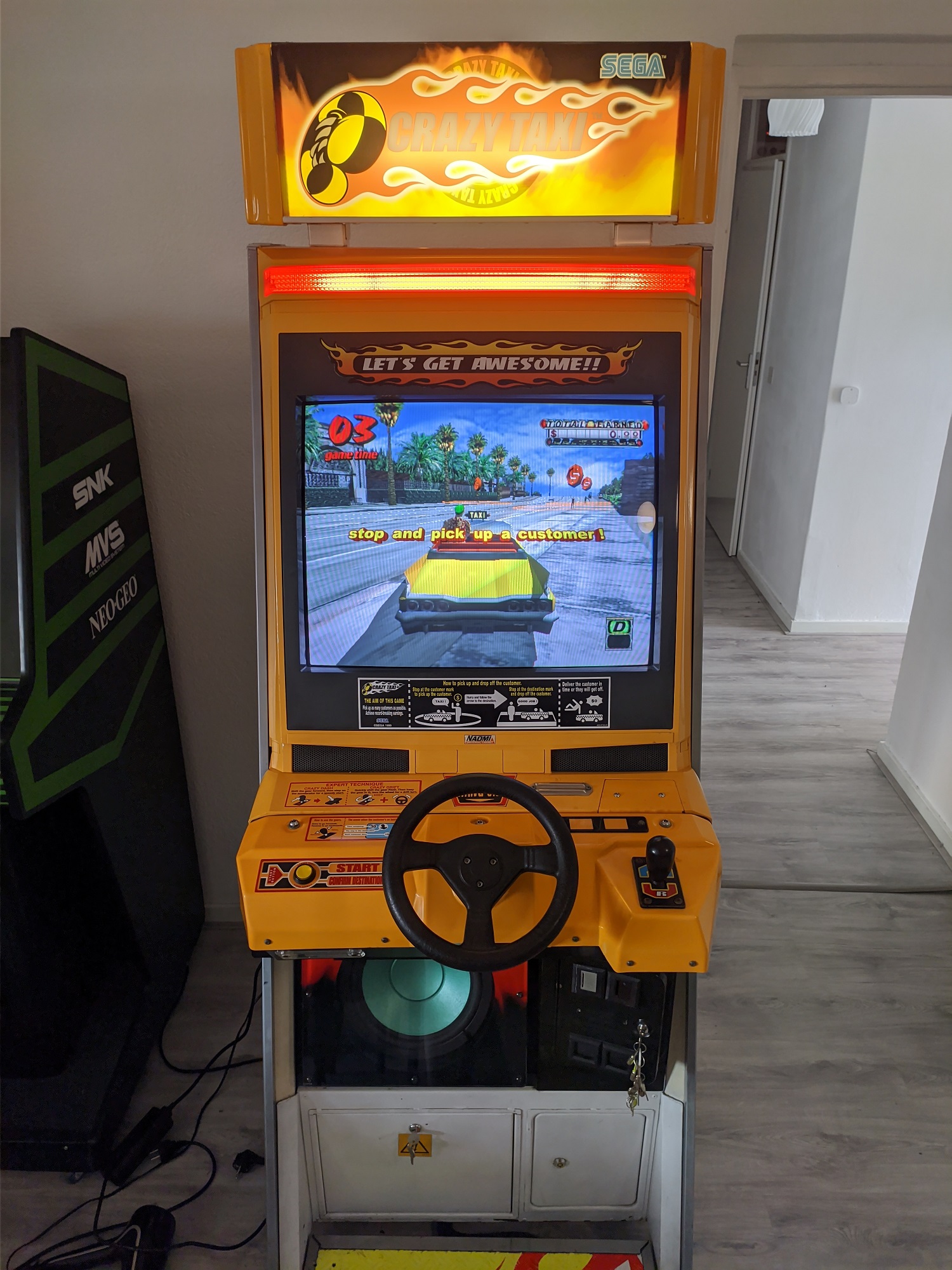

And remember this Italian mess?
Look again
Now add the missing flame sticker and you get a result I'm very proud of :)

"Let's get awesome" well, you sure did that
You did an amazing job imo, and not only that, but Sega chose a great color for a game like this.
Stunning cabinet, great game.
