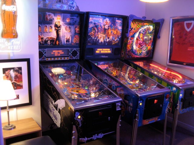

Here you go Ian...
The Pins and the Neo Geo cab. Space Invaders and Pac Man are too unwell to be phot'd at present.
When nursed back to health and installed in Games Room II I'll pop pics of those on too.

Both cabs are in great condition and Andy has a great setup. would be great to see some pics on here.
